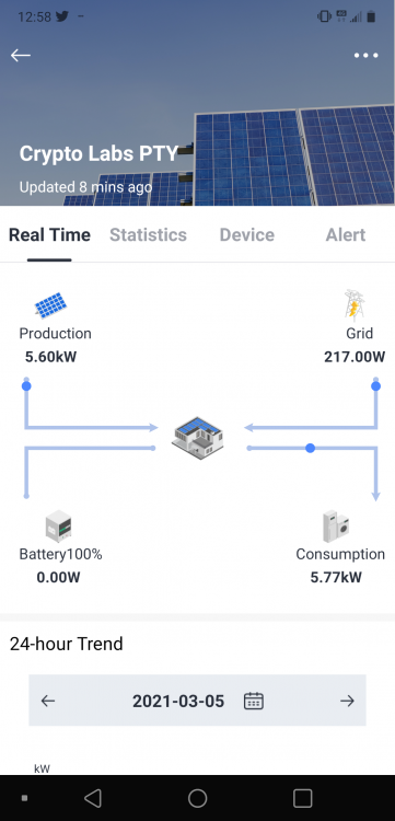

I am looking to expand my panels,(have 10x400W with the Sunsynk 5.5, currently setup with 4 and 6 on each string) I see you mention 16 x JA 455w panels  = 7280W  total  while the SunSynk specs indicate 6500W  max and Keith gave feedback on Sunsynk forum "The 5.5 kw invert has 2 x 2.75 kw mppts if the voc is high the current will clip" ,  how have you setup your panels  and is this working without any damage or clipping ?
No panel ever generates the rated max power in real world condition.
Regardless even if you did put +6500w capacity on the MPPTs it will only use what it can. The panels generate a voltage and the load(MPPT) takes current. The panels are not a current source. It do not increase its voltage to get a current flow going. It will reach a max voltage if there is no load. It will not increase above this to force a current. If the load is too much it will not be able to provide sufficient current and the voltage will drop. Using this first principle there is no risk to the MPPT if the panels has the ability to provide more power(voltage x current) than what the system can take. Max input Voltage of the MPPT is the risk. This is the only risk.
As the inverter has two MPPTs I have 8 panels on each in series. Max voltage when no load is well under the 400v of the MPPT. I was very tempted to use 9 but as that is very close to the max voltage of the MPPT I decided to play it safe.
On a good day I can generate 5800w
