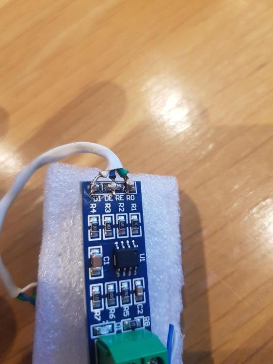

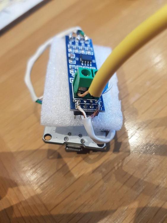

On 2023/08/12 at 9:45 PM, Ivan Endicott said:

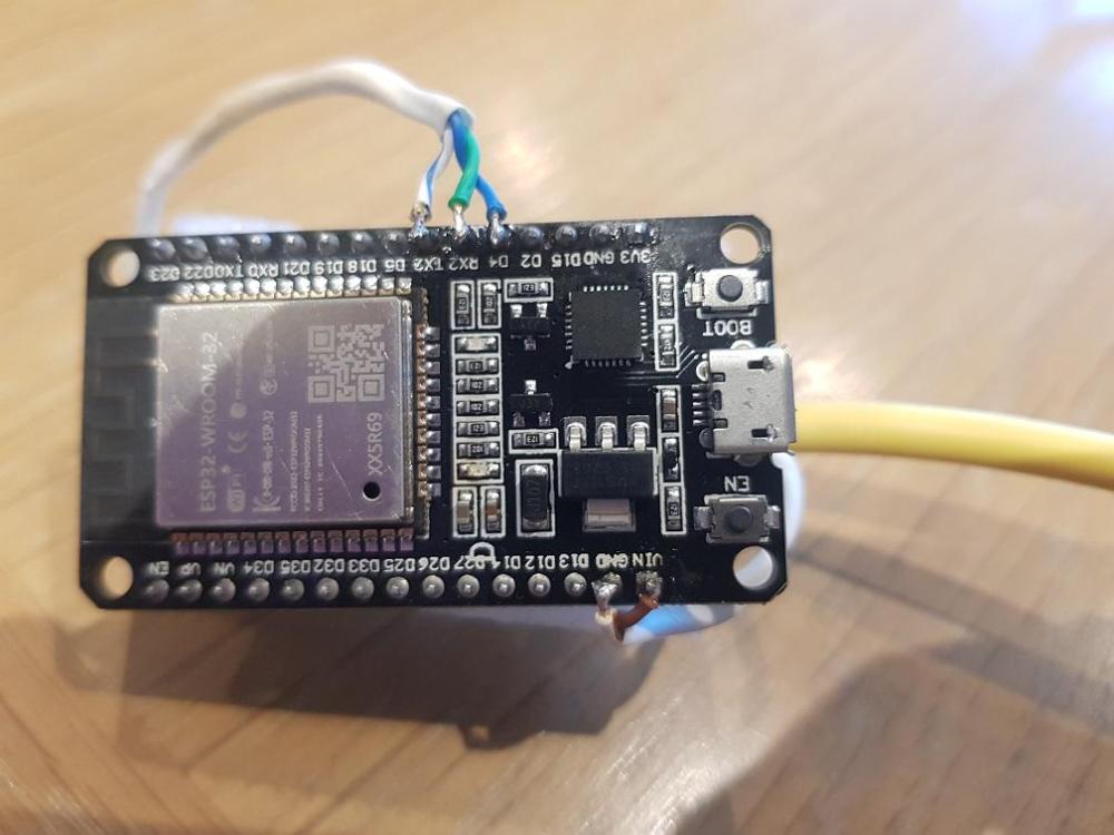

Hi Folks,
Been building the ESP32 and RS485 project up to connect to an inverter (I am UK based).
Anyway bought an ESP32 DEV board and this TTL > RS485 board
I've wired them up as described and followed the instructions. I can now see the ESP board in Home Assistant fine but when I click on it there is only 1 entity which is "ESPHome Web 137a18 Firmware".
I have tried the following:
  • Removed the R7 resistor
  • Tried a second TTL > RS485 board
  • Tried a second network cable
  • Reversed the network cable wires that are in the TTL > RS485 board
  • Remove the plugin fully (Including removing the old directory left) in Home Assistant
  • Flashed the board a few times.
  • Re-seated the RJ45 into the inverter
  • Reheck and re-soldered the wires again
When I check the logs I only get a few lines around the setup see the attachment INFO attached ESPHome 2023.7.1.txt (I have hashed out the MAC), there is no data coming from the Inverter other than the output.
I am not sure what else I can do.
Any help I would be greatful.
Regards Ivan

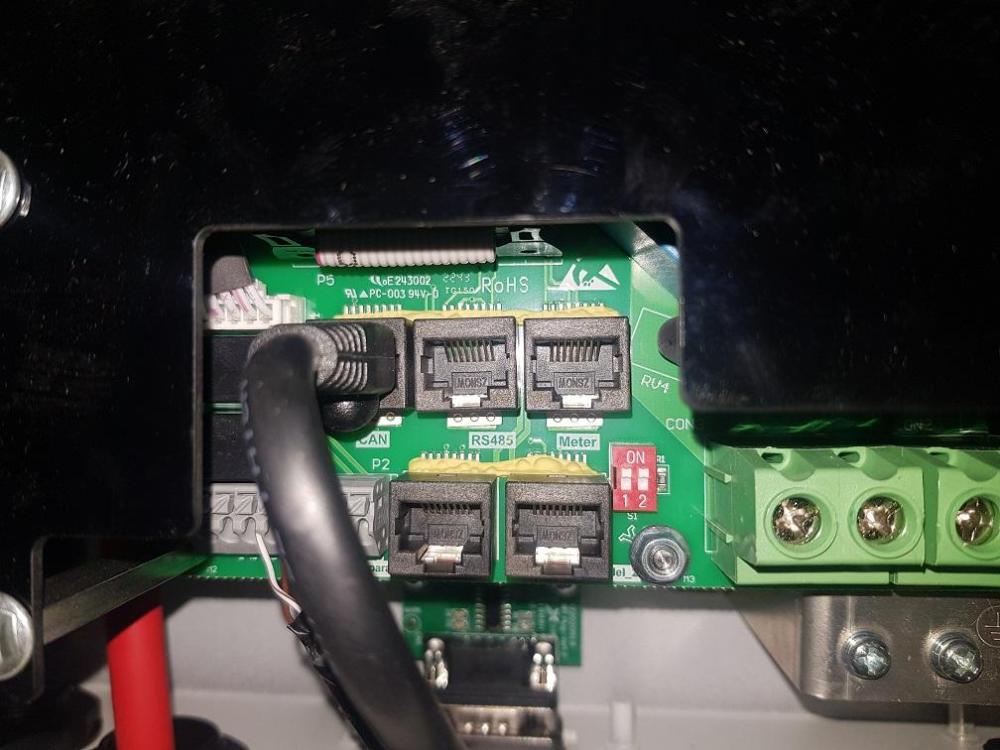

2 things from your pics seem off re the Ethernet Cable:
First and foremost - you need to plug it into the jack labelled RS485 - it's currently plugged into the CAN. See if you start getting data once you've changed this.
Secondly, your first image shows a yellow network cable and the other end shows a black network cable.... If the above suggestion does not work - perhaps re look at how you've wired the network cable.

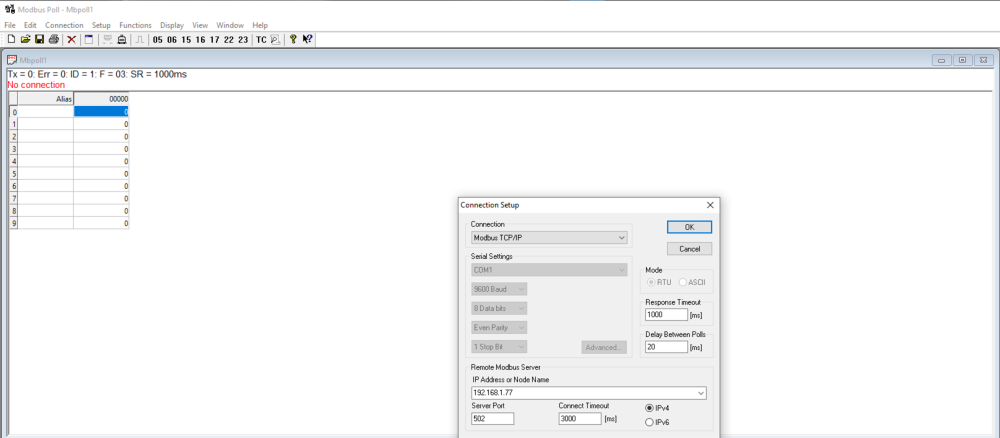

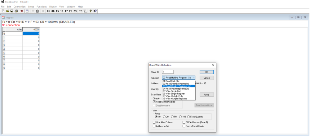

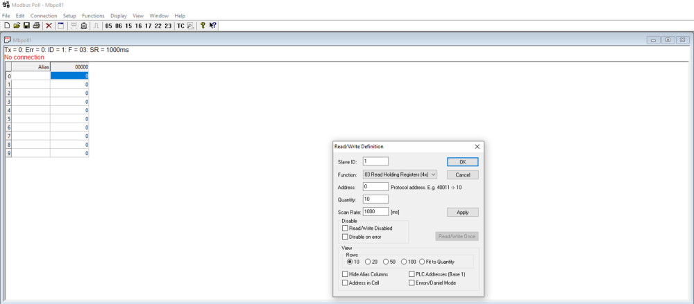

Modbus Poll works well to do fault finding on RS485/Modbus RTU or even Modbus TCP
Please expand on your comment on Modbus Poll works well for fault finding.
Modbus poll is a software read and write modbus registers
You can use it to lookup modbus RTU(RS485) or modbus TCP(Ethernet)
All the register types are available...
For Modubus RTU/RS485 you will need a USB converter for the PC.
Modbus TCP uses the PC Ethernet port
Edited by Yuri

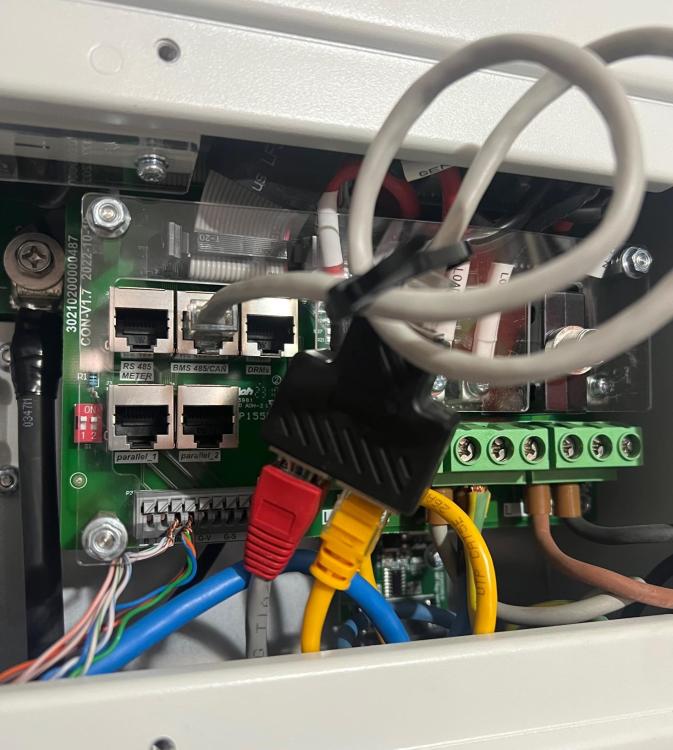

On 2023/08/13 at 10:58 AM, XianZA said:
Hi thanks for the advice @XAB@XAB it turned out to be exactly this. All the guides say top left port and it even says RS458. I came accros that 2 in 1 port and thought to myself there is no ways as mine is has a dedicated RS458 and its on the top left. Anyway when reading @fStofs post I thought just maybe and the plugged out battery cable and it just worked. sorry I couldn't reply been working. Made myself a 2 in one cable for the time being and have ordered one of those rj45 splitters. Just need to get the rest of the dashboards graphs working as some of the sensors have esphome in them.

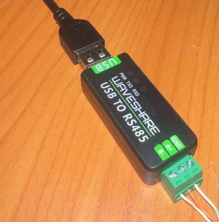

Glad I could help @XianZA. I have now connected both cables on the BMS 485/CAN of my SUNSYNK 5.5KW(newer model) with the below RJ45 Duplicator (Important to get one that does not split the pairs but rather "mirrors" it). I connected Orange to A+ - Orange/WHT to B- and Green/WHT to ground on my USB to RS485. Now I can update settings via HASSIO finally.
Important to note that the RX / TX works on pins 1(Orange/WHT) and 2(Orange) and your battery on pins 4(Blue) and 5 ( Blue/WHT). I tested this first when getting the RJ45 splitter/duplicator.
Prior to this I could receive data via the RS485 port next to the CAN port(left of it) but had to use Blue/WHT(A+) & Blue (B-) from the cable to receive data via the USB to RS485. But could not update as the RS485 port only allowed to receive data.
Image of RJ45 Duplicator into BMS 485/CAN
Image of USB to RS485

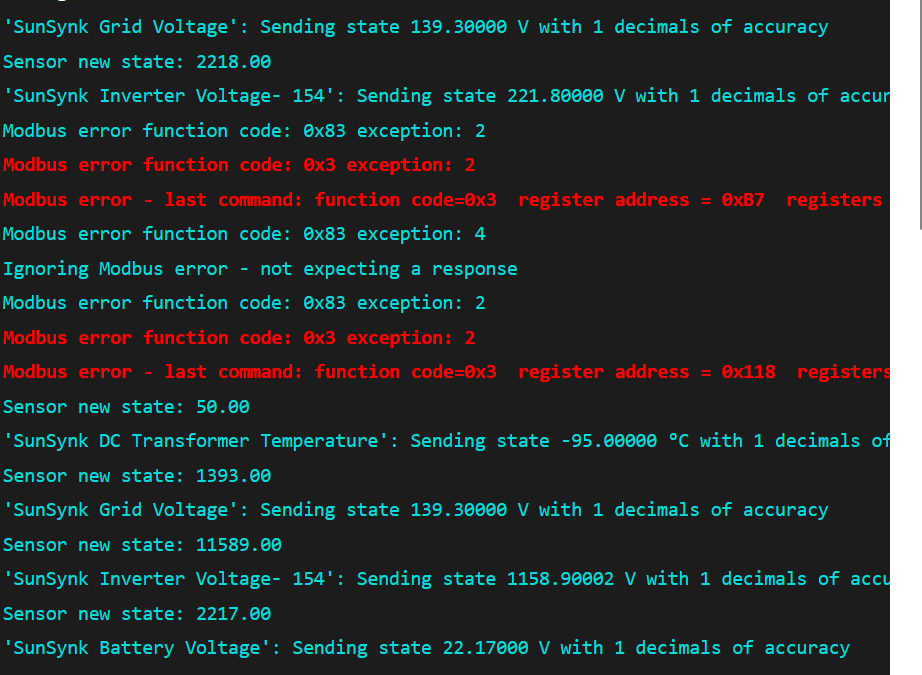

Ah OK, if I am seeing Errors like this
[23:46:01][W][modbus_controller:113]: Duplicate modbus command found: type=0x3 address=154 count=1
[23:46:01][W][modbus_controller:113]: Duplicate modbus command found: type=0x3 address=160 count=1
[23:46:01][W][modbus_controller:113]: Duplicate modbus command found: type=0x3 address=164 count=1
and
[23:46:05][D][modbus_controller:032]: Modbus command to device=1 register=0xA0 countdown=0 no response received - removed from send queue
[23:46:06][D][modbus_controller:032]: Modbus command to device=1 register=0xA4 countdown=0 no response received - removed from send queue
[23:46:08][D][modbus_controller:032]: Modbus command to device=1 register=0xA6 countdown=0 no response received - removed from send queue
Is this a wiring issue or sensor issue please?
Thanks Ivan
I am struggling with these same error logs as well, I even changed the esp32 thinking it was a hardware error, the error logs persist.
Thank you. This turned out to be my trouble too. After using port splitter the comms started. However the stats seems off

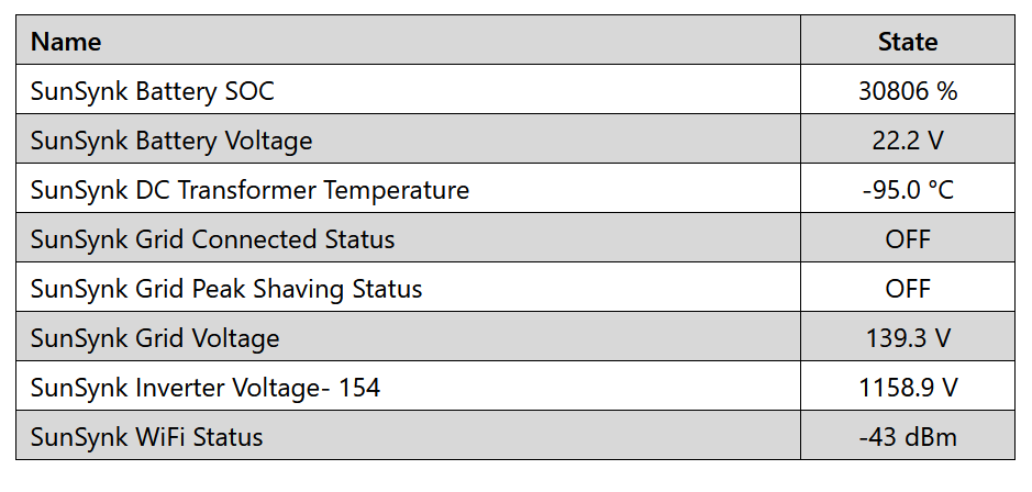

hi all, not sure what is going on or if missed something,  after making some progress above, i have noted that my numbers are not making sense as shown below, i decided poll voltage related value to see if i could pickup anythin that can help.  As you can see these values dont make sense, even grid says its off even though i know its connected.
The related info from logging, also not sure why the two errors pop up on very run.
