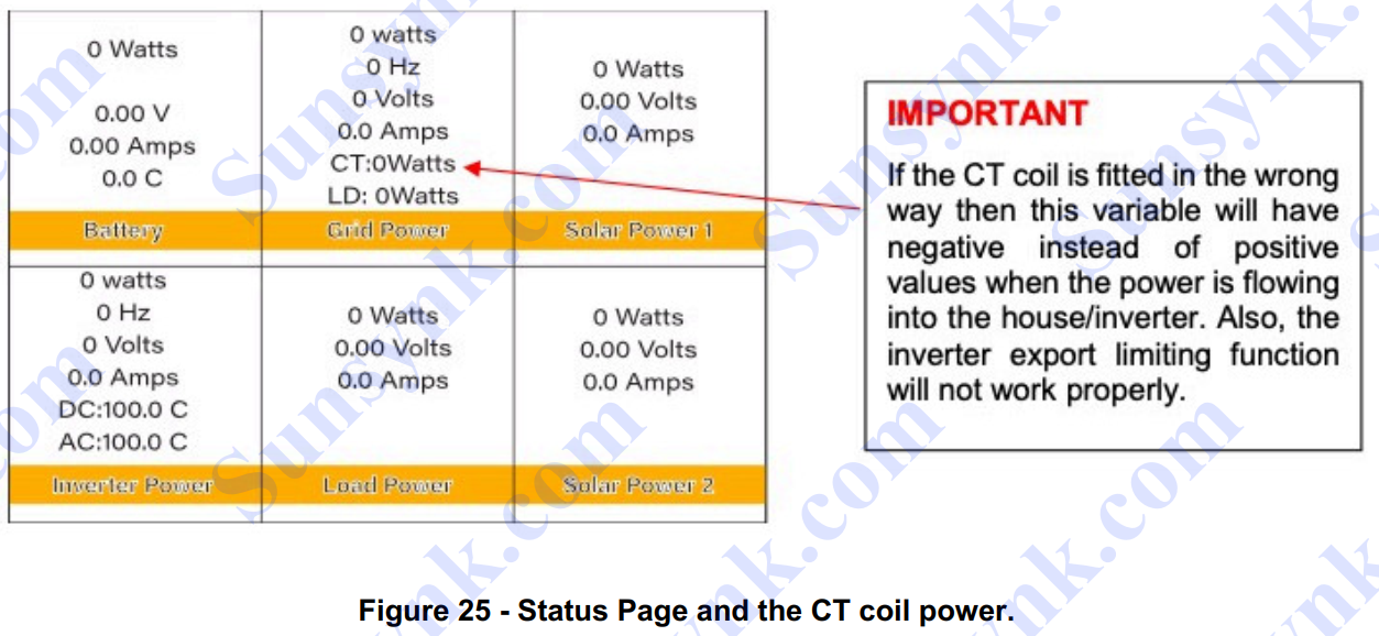

MINUS Posted July 18, 2021 Share Posted July 18, 2021 (edited) Hi all, Recently installed Sunsynk (5 weeks running OK and impressed with the machine). It threw out the following codes this morning - have checked forums and manuals - wondering if anyone has seen them before. I suspect bad grid power has something to do it - will see how it runs tonight again. Sunsynk 5Kw 2 x Pylontech US3000C 10 x JA 455s (Used in area with Prepaid meter) Hoping someone can help with: 1. Anyone seen any of the codes before? Particularly F03. Also why F13 is continuously coming up every 2/3mins before the DC Low came up. It might be linked to this - but what would prevent the inverter from switching to grid when the batteries reach the specified time of use SOC - e.g. 35% below? Bad grid being filtered by the inverter settings? 2. CT coil - have watched the videos - I have the old software. The software has a “HM” signal to show wattage and this is reflecting a negative wattage - which I take to mean they installed it the wrong way? I know it clearly says CT on the new software - just confirming my assumption that this used to be “HM” on the old screens? I’m set to Zero export>Load only so hopefully no impact. Will correct the CT coil and switch to HM load too. 3. When exporting once battery is full to non essentials - this is ONLY excess solar right? I.e. non essentials will not use battery. 4. My time of use functions are included below. I’ll tweak them a bit for loadshedding - however - what would happen if I changed the 35% to say - 50% in all lines that have 35%. And the Grid went off. Would the time of use settings mean that I couldn’t use my power if my batteries were down to 50%? Or does time of use get overridden when grid is shut down. Thanks - apologies if these have been asked elsewhere. Has anyone received the beta of the new data logger? Interested to know thoughts. Cheers and thanks in advance. Time of use: Fault codes - note grid was down when pic was taken. I suspect bad grid caused this but not sure why the inverter didn’t switch to the grid when the batteries hit 35%. Edited July 18, 2021 by MINUS Quote Link to comment Share on other sites More sharing options...
Yellow Measure Posted July 19, 2021 Share Posted July 19, 2021 If you have old software, then as a start, I'd recommend updating it. On your error codes, I have never seen them before, F56 is a battery related error, check cables, connections, battery discharge settings and condition of battery. F13 seems informational, suggests that someone was changing grid mode / work mode parameters. And as for F03, I don't know what GFDI stands for. If your CT coil is installed incorrectly then the CT value in the info screen will be negative: Quote Link to comment Share on other sites More sharing options...
MINUS Posted July 20, 2021 Author Share Posted July 20, 2021 Thanks YTM. Sorted on the CT coil. I don’t have the dongle yet so will hang 5 for an upgrade while I wait for mine. Appreciate the response. Yellow Measure 1 Quote Link to comment Share on other sites More sharing options...

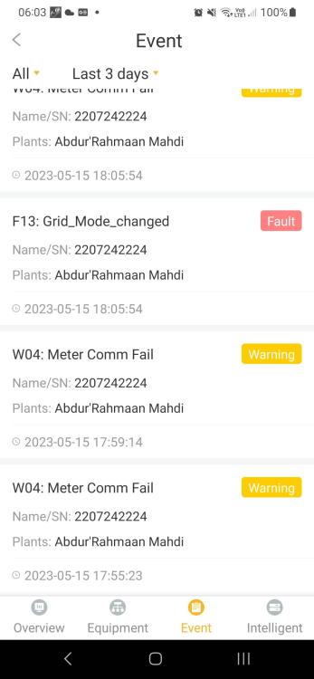

Abdur Posted May 16, 2023 Share Posted May 16, 2023 Good day I have a problem with my 5.5 kw Sunsynk inverter, it gives me this fault as a warning : Wo4:Meter comm fail. please let me know via mail: [email protected] Kind regards AR Mahdi Quote Link to comment Share on other sites More sharing options...
mzezman Posted May 16, 2023 Share Posted May 16, 2023 18 minutes ago, Abdur said: Good day I have a problem with my 5.5 kw Sunsynk inverter, it gives me this fault as a warning : Wo4:Meter comm fail. please let me know via mail: [email protected] Kind regards AR Mahdi do you have an external meter connected to the inverter? Quote Link to comment Share on other sites More sharing options...
Abdur Posted May 16, 2023 Share Posted May 16, 2023 3 minutes ago, mzezman said: do you have an external meter connected to the inverter? No a CT coil Quote Link to comment Share on other sites More sharing options...
Abdur Posted May 16, 2023 Share Posted May 16, 2023 No,I have a CT coil installed Quote Link to comment Share on other sites More sharing options...
Abdur Posted May 16, 2023 Share Posted May 16, 2023 Does anybody have a answer for me? Quote Link to comment Share on other sites More sharing options...
Abdur Posted May 16, 2023 Share Posted May 16, 2023 Quote Link to comment Share on other sites More sharing options...
mzezman Posted May 16, 2023 Share Posted May 16, 2023 1 minute ago, Abdur said: Which ports is the CT coil installed in? Did it work before or has it always been like this? Quote Link to comment Share on other sites More sharing options...
Abdur Posted May 16, 2023 Share Posted May 16, 2023 It always worked before, it is only now lately that the problem accured Quote Link to comment Share on other sites More sharing options...

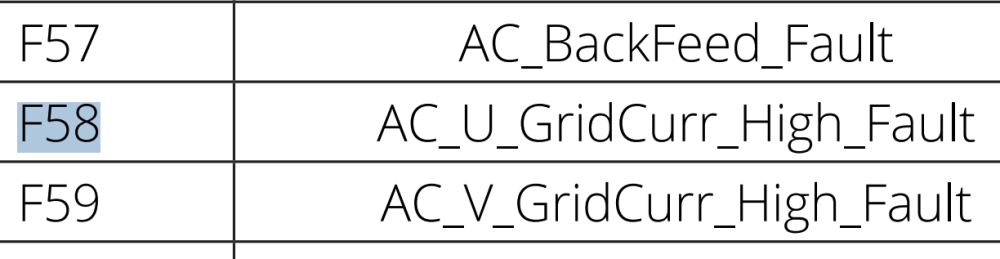

Yellow Measure Posted June 5, 2023 Share Posted June 5, 2023 1 hour ago, Celeste said: Hi YellowTapemeasure The error code was F58 BMS Communication Fault. I typed the code out incorrectly in my first message. We have all our lights, fridges, televisions, microwave, kettle, pool pump and all electrical outlets on the inverter (batter is mostly charged by solar). Only the geysers and oven are on Eskom. Thanks That's actually wierd, because the Sunsynk manual states F58 is a Grid Current High fault: Quote Link to comment Share on other sites More sharing options...
