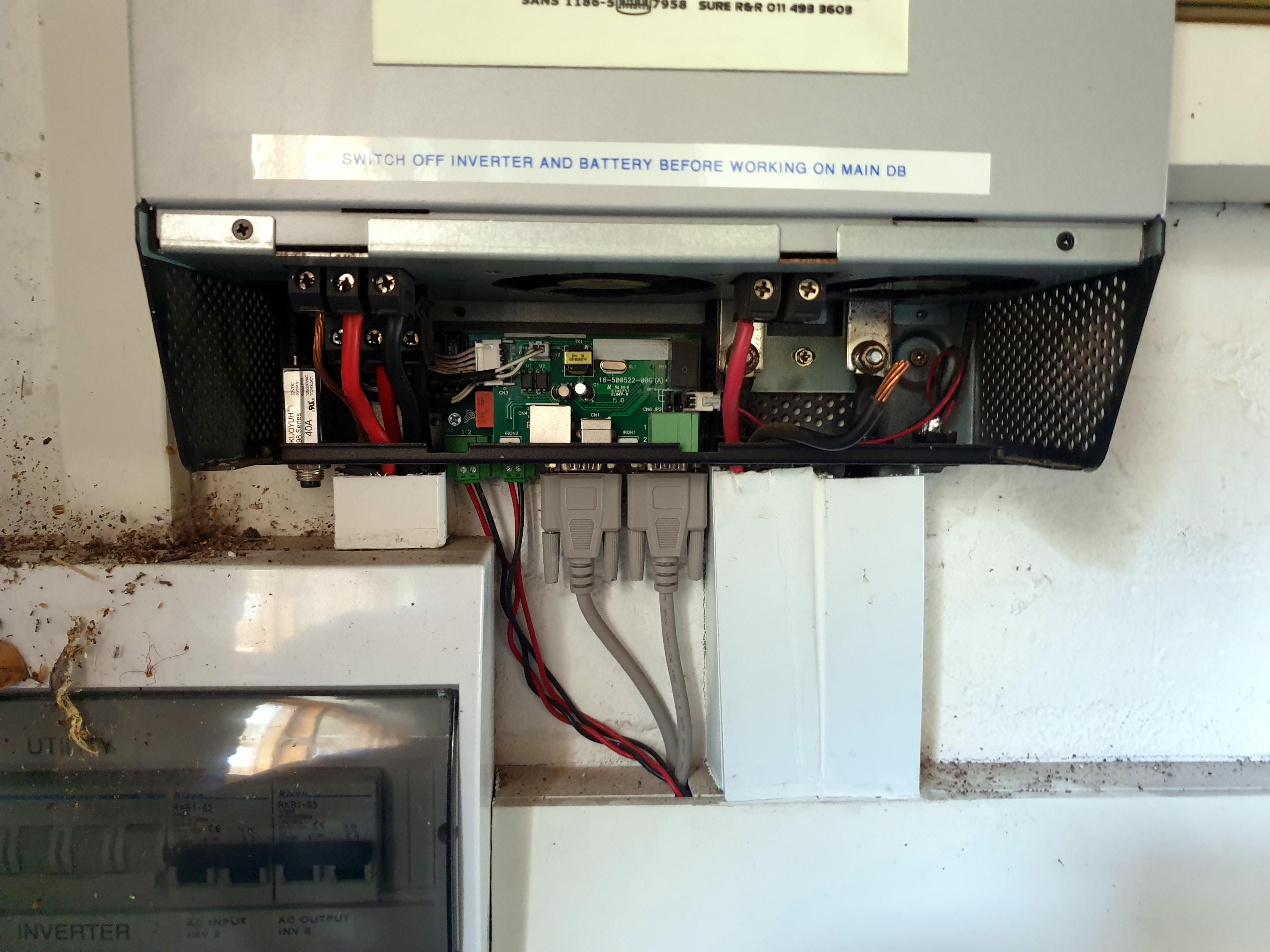

A resident in my neighbourhood (Tokai, Southern Suburbs) posted a plea for assistance with his PV system. The various companies they contacted don't want to help as it's not their install. They just bought a family home & moved in a few months ago. The pre-existing solar system is failing & they are wanting to resolve the issues. While I'm not qualified I decided to pay them a visit & lend them some insight. I've installed a few inverters for my family so I'm not totally useless ;)
Your input is welcomed & I'd like to take our collective feedback to them and offer them a way forward. Please see the attached pictures & video link below.

Hi again WJP, not sure if you have spotted it already or maybe you have not. There is a red & black cable which I assume is the Solar PV input wiring. The black or negative wire is loose & looks to be in close proximity to the battery cabling below. Worth a long crack shot but might be the source of some of the issues.
Goodluck. Hopefully these guys can get to some electricity production again...
87

Thanks bud, I was trying to troubleshoot the faulty inverter. Part of that process was removing as many variables as possible. At one point I only had the basics connected to power up the unit which is basically DC power & AC in. You are correct that is the PV input wire. I reconnected it after the photo was taken.
