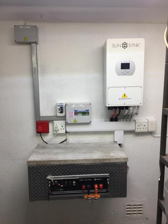

Gerrie Posted August 21, 2021 Share Posted August 21, 2021 Just replaced my Axpert with the Sunsynk 5.5 situated in my garage, It is powered up and everything seems to work first time, still a bit of reading and experimenting to do with settings and WiFi dongle that I need to figure out but “WOW” what a machine. Everything about it feels and look like quality. It was quite easy to fit as most of my wiring was already in place except for the CT coil wiring that was a bit of a mission because my grid main cable is about 20 meters away from the inverter and I had to extend the CT coil wires to reach all that way and than changing my PV panels from parallel strings to series. Than fitting the earth bond relay easily inside the inverter, Also my DB in the house was previously upgraded and split into three sections when I first installed the previous Axpert. I did’nt use the PV string connectors on the bottom of the inverter but rather entered the PV wires through a sprag pipe in bottom of inverter. WannabeSolarSparky, hoohloc, Yellow Measure and 1 other 4 Quote Link to comment Share on other sites More sharing options...
Gerrie Posted August 21, 2021 Author Share Posted August 21, 2021 The DB is bit cramped because of lot of circuits but still good Quote Link to comment Share on other sites More sharing options...

JUA Solar Posted September 1, 2022 Share Posted September 1, 2022 Nice Install. Curious to know which comms cable did you use between the inverter and the battery? Thanks Quote Link to comment Share on other sites More sharing options...
BryanOC6 Posted September 2, 2022 Share Posted September 2, 2022 Nice install !! yeah don’t see a comms cable between the Pylontech and the inverter Quote Link to comment Share on other sites More sharing options...
Gerrie Posted September 17, 2022 Author Share Posted September 17, 2022 On 2022/09/02 at 6:16 AM, BryanOC6 said: Nice install !! yeah don’t see a comms cable between the Pylontech and the inverter Thanks, the comms cable is black not easy to see on photo, plug into can port. BryanOC6 1 Quote Link to comment Share on other sites More sharing options...
Lee2 Posted September 23, 2022 Share Posted September 23, 2022 What are all those plugs and lightswitches for next to the inverter? What powers them and what in turn do they power? Quote Link to comment Share on other sites More sharing options...
Gerrie Posted September 23, 2022 Author Share Posted September 23, 2022 11 minutes ago, Lee2 said: What are all those plugs and lightswitches for next to the inverter? What powers them and what in turn do they power? The white sockets and light switch is existing things for my garage. The red plug however is a dedicated Eskom socket that feed my inverter. I did not fit a isolator like most installers do I decided on a socket so if I unplug it there is no Eskom power to the inverter and its than completely off-grid. Quote Link to comment Share on other sites More sharing options...
Gerrie Posted September 23, 2022 Author Share Posted September 23, 2022 Just now, Gerrie said: The white sockets and light switch is existing things for my garage. The red plug however is a dedicated Eskom socket that feed my inverter. I did not fit a isolator like most installers do I decided on a socket so if I unplug it there is no Eskom power to the inverter and its than completely off-grid. That photo is bit old I did install a new DB next to inverter, that was just a temporary little board in beginning to get my solar going. Quote Link to comment Share on other sites More sharing options...
Antonio de Sa Posted September 23, 2022 Share Posted September 23, 2022 5 minutes ago, Gerrie said: The white sockets and light switch is existing things for my garage. The red plug however is a dedicated Eskom socket that feed my inverter. I did not fit a isolator like most installers do I decided on a socket so if I unplug it there is no Eskom power to the inverter and its than completely off-grid. Sorry maybe a stupid question, if you feed your inverter with a 15 Amp plug, you can only get 15 Amps to your load when you on Eskom, the 2,5 mm2 can only safely carry 15 Amps Quote Link to comment Share on other sites More sharing options...
Gerrie Posted September 23, 2022 Author Share Posted September 23, 2022 You are correct I never go more than about 10A my loads are managed with Sonoffs and Astute’s. I still have to swing the inverter cable over to a isolator the red plug was perfect with my old Axpert but the Sunsynk needs a isolator. Quote Link to comment Share on other sites More sharing options...
