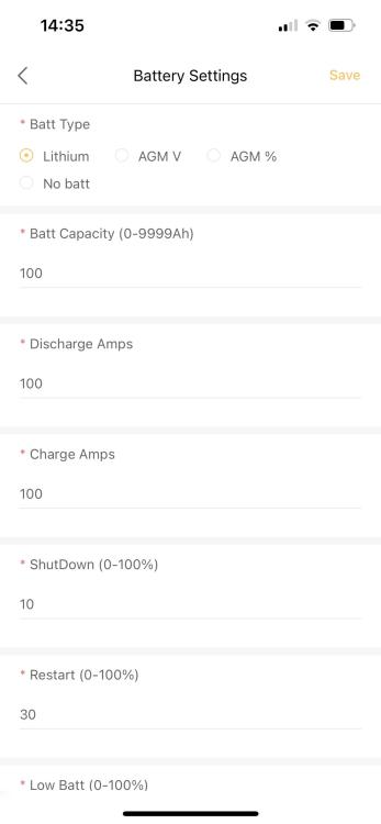

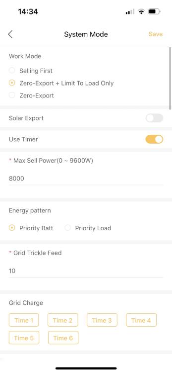

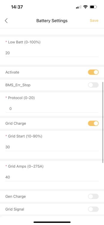

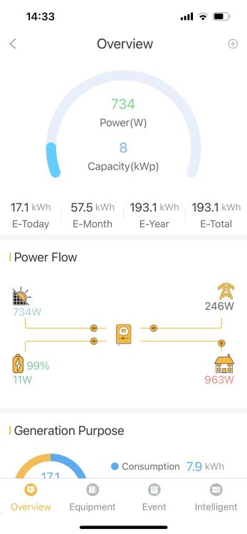

I have a new Sunsynk inverter with 2x Hubble Litium batteries. My solar panels are loading my batteries up to 100% charge, but then my grid starts feeding paid electricity. Why does this happen? I believe my settings are correct. Grid should only kick in when batteries are below 25%. See images from my App below. I am adding my battery settings as well in case that is where the fault lies.
Would dearly like some feedback.
