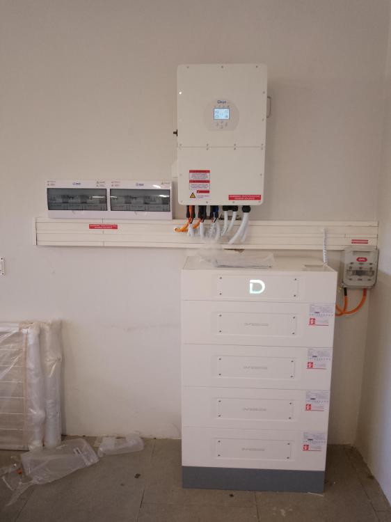

June 14Jun 14 Good DayMy first installation done.PV Modules: 40x Canadian Solar 615W panels (8 per string/ 5 strings). Total installed capacity 24.6kW. East/West configuration.Inverter: 30kW Deye 3phase Hybrid.Battery: Deyeness Stack 4 Tower 57kW. Operating voltage 230V (4 stacks plug and play in series).Location: Hermanus.Check- no surface mounted trunking from panels to inverter and DB to inverter. In conduit under plaster. Edited June 14Jun 14 by Ruandré
