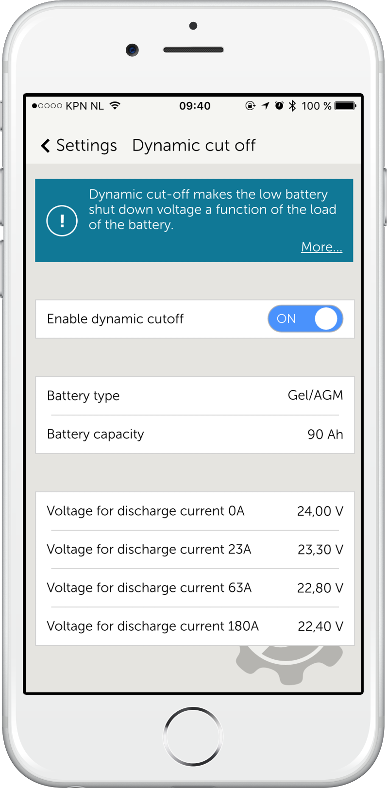

Any case, it has a very cool feature: Inverter Dynamic Cutoff. I like this with the batts I use, they are old, so the load jumps, volts drop, inverter switches off. Now it can be managed.
Here is more info:https://www.victronenergy.com/live/ve.direct:phoenix-inverters-dynamic-cutoff

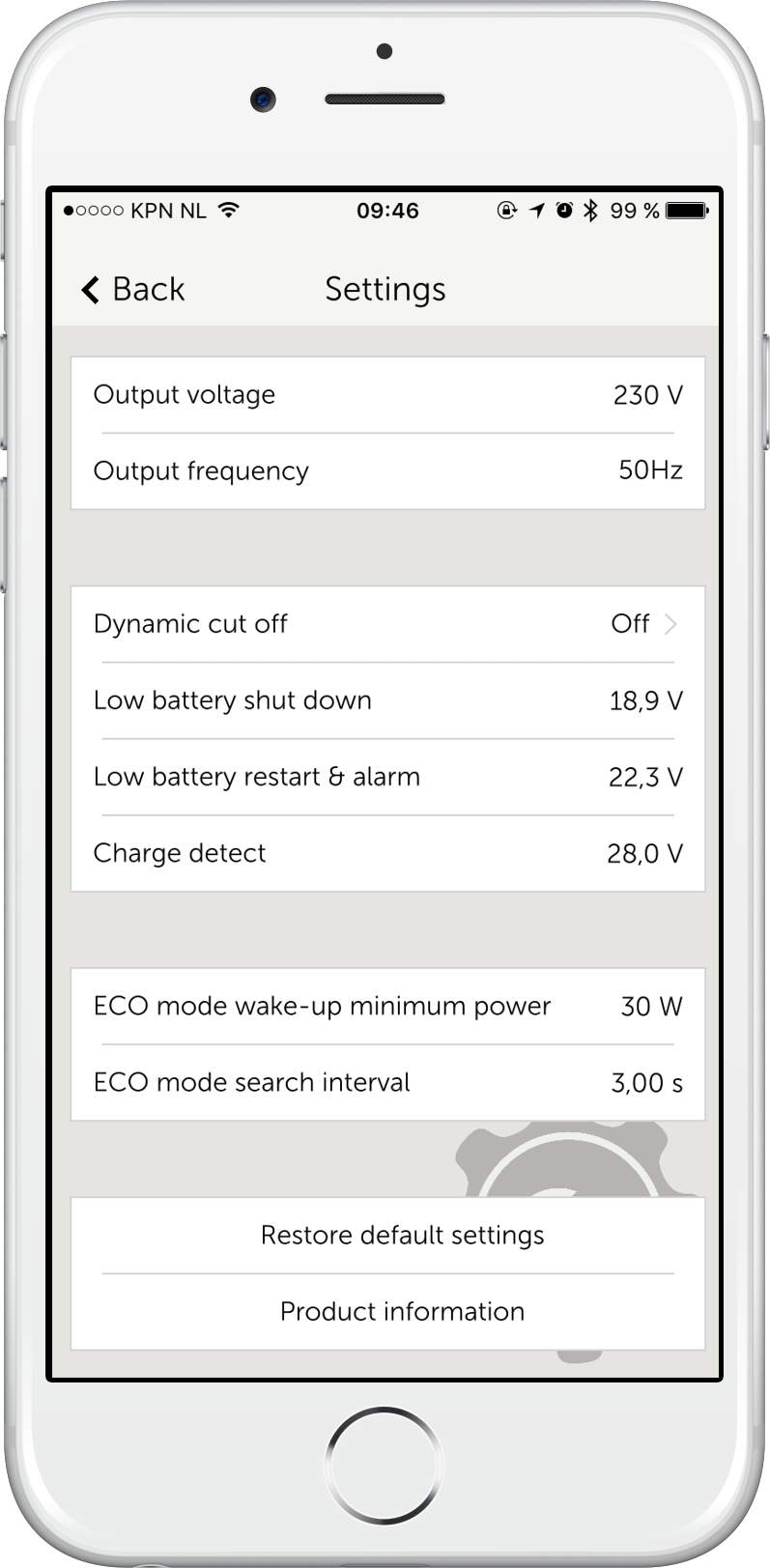

Settings: https://www.victronenergy.com/live/_media/victronconnect:vc_iphone_phoenix_dynamiccutoff.png
https://www.victronenergy.com/live/_media/victronconnect:vc_iphone_phoenix_settings.png
