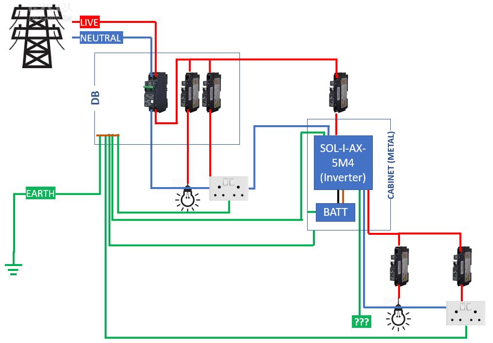

I need a little bit of advice on wiring please.  I looked through the topics but could not find something simplistic that explains specifically what to do about grounding, avoiding grounding loops and keeping partial loads (stove, geysers) direct on utility (also did not want to hijack someones thread).
Illustrated below is what I intend on doing but want to check up on a few things first,
1.  Do I have the wiring correct?
2. What about the cabinet grounding, with the battery grounded to the cabinet but the inverter grounded from the grounding bar?
3. What do I do with the output ground from the inverter?
4. Is it correct/required to keep the output neutral completely separate from all neutrals before the inverter?
Ignore the changeover switch required in case of inverter failure.
Thank you for the support, much appreciated.
Prash.
