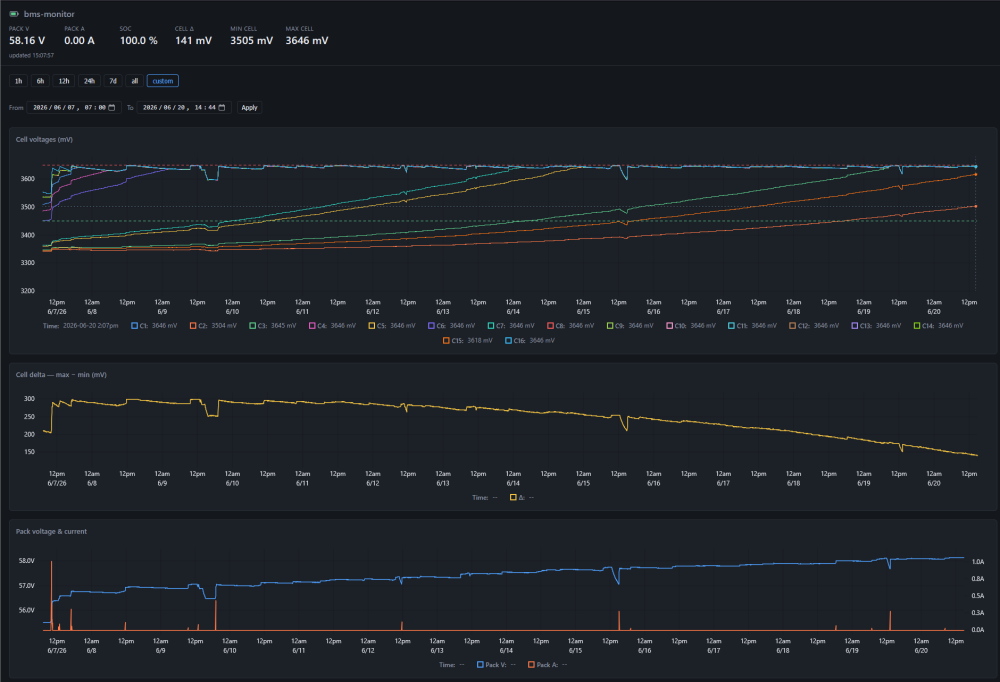

I took Kamusial's advice and decided to be more proactive with the balancing. Doing it via the inverter is viable but the imbalance of the pack was worse than I thought, with Battery 2 having an imbalance of 300mv at top of charge. Using the inverter meant I needed the batteries to be at 100% for days on end which just isn't possible in my household in winter. So instead I purchased a 60v/5Amp bench power supply and started to balance the batteries manually.
The process so far has been:

  • To manage this whole balancing process, I vibe coded a Hinaess Battery Monitoring system that I ran on a Raspberry Pi 3 with a RS485 to USB converter. It's great because it gives me graphs to monitor whats happening and updates every 30 seconds.

  • If you have 1 or 2 cells that are way higher than the rest of your pack, then balancing is quick and easy. If you look at the graph you can see in the first few days how the balancer quickly brought Cell #16 into alignment with a group of others.
  • If you have a pack with cells that lag very far behind the rest and the cell voltage difference is over 200mv, then you are in for 1 to 2 weeks of balancing. I believe my last lagging cell will match with the others in the next 3 days, so that will be just over 2 weeks of non-stop balancing 😭
  • Balancing seems to work best when the highest cells are at 3,648v.
  • I didn't need a very strong power supply - the 60v / 5Amp version was plenty.
  • For the first 4 days or so Cell #2 barely moved. I though it might never improve but over 2 weeks it has finally come up.
  • Time will tell if Cell #2 was just behind since I purchased the battery or if it is just completely mismatched with the other cells in the battery.
  • As mentioned, the balancers turn on and off and random times and I could not spot a pattern. My suspicion is that if the balancer has been running for a long time then it eventually turns off for an unknown amount of time.
  • If any cell goes over 3,650v then the pack will go into over voltage protection. I would have to reset the pack when that happens by holding in the reset button for 10 seconds.
