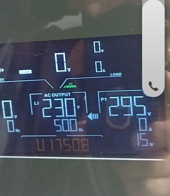

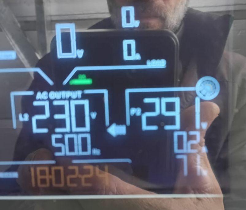

6 hours ago6 hr Hi,A few years since my previous intallation, now have installed 12x Monocrystalline 625w panels feeding Voltronic Axpert MAX II 11 KWh with CPU 1 7508 and CPU 2 3928tied to Pylontech Pylontech Fidus Plus 16Kwh 51.2v 300Ah After a couple of days the Panels show these numbers on a lightly clouded day:- P1 295v (with 0 A and 15 watts ?)- and P2 291v (with 0,2 A and 71 watts ?) And both move to around 310 on sunny times, however still with near zero A and watts figures.That is the first question, shouldn't the A and watts numbers be quite higher? What could be causing this?Then the inverter is configured as single Phase and I have respected the numbers that choosing PYL at menu n° 5 determines for it.Apart from those, it has SBU as priorities and 220v and 50 hz as those are what we use here.I have installed the special RJ-45 BMS cable with PYlontech marked end to the battery and the other connected to the inverter.That all said, when operating the inverter disconnected to the Battery I have only minutes of power and then shuts off. The LCD screen shows sequentially as P1 with around 300v and then 0 to then show P2 with 300plus voltage and then 0. I have tried configuring the minimums with no results so far.Any ideas, tests of further info I should look up?Thanks Edited 5 hours ago5 hr by Nspace
