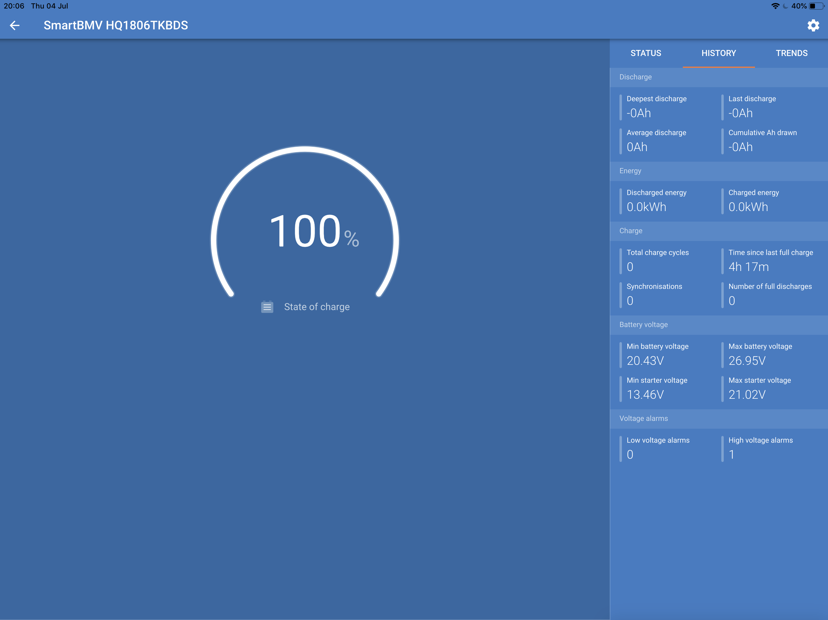

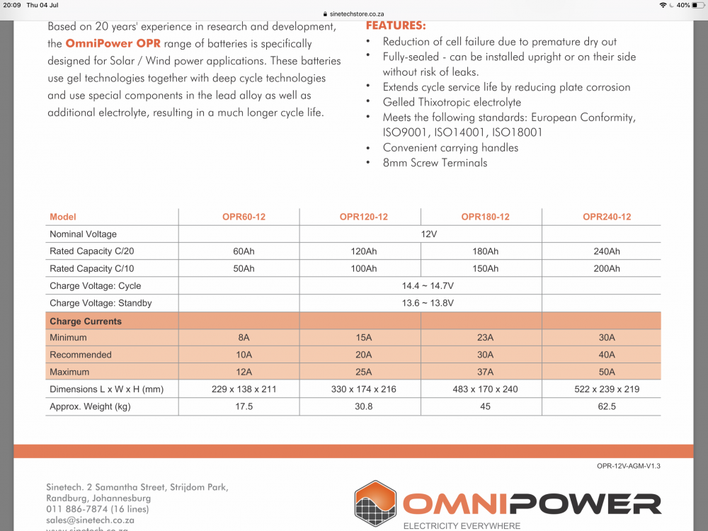

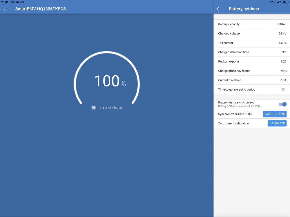

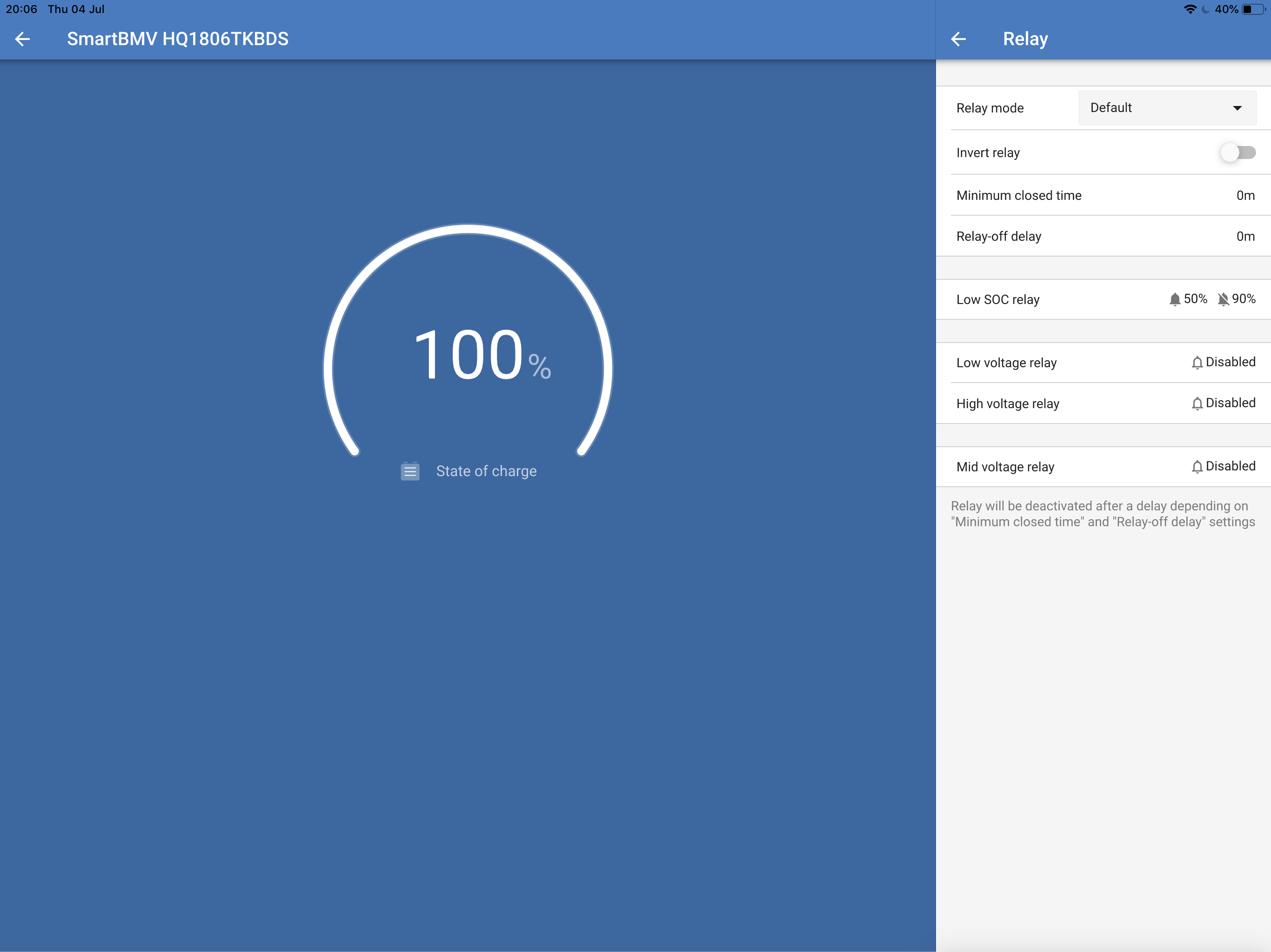

Hello I want to confirm that all my settings is correct for my system on the BMV. I have a axpert 3kva with 2 12V omnipower agm/gel 240ah batteries. Please see my screenshots will really appreciate advice
