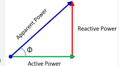

I figured P Q and S
S = Apparant power
P = Active power
Q = Reactive power (you want to get this one low)
S = Square root of (P^2 + Q^2)
More specifically, I've worked out that S = sqrt((P1-P2)^2 + (Q1+Q2-Q3-Q4)^2). And I found https://clouglobal.com/the-four-quadrant-diagram-in-electricity-metering/ helpful in understanding why there are four Q values: basically it separately measures inductive and capacitive reactive power, during importing and exporting. I'm not convinced that formula is really meaningful: if you import 100W for t/2 minutes then export 100W for t/2 minutes (with no reactive power), then the average apparent power over t minutes is still 100W, not 0W.
