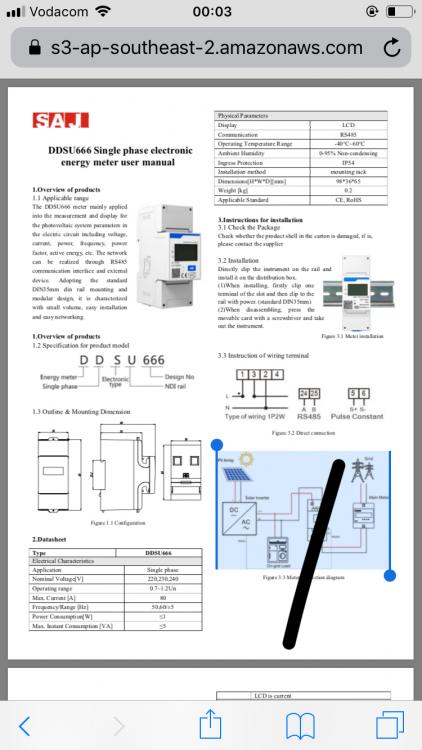

July 23, 20223 yr Good evening, I have been installing my new Growatt MIN 5000TL-XH all day and I'm close to having it running. I however have one problem I cannot find anywhere and don't like to wire it wrongly and make a mess of the whole system. The supplier sent me some info but it was of no use to me (I bet they are not too sure about it); no matter how hard I try, I cannot find any information about how to wire the meter, so I can program the inverter not to allow any power produced to be dumped to the grid. Funnily enough there is plenty of information on how to wire and connect an Eastron SDM230 Modbus, but the the one I received from the supplier is a CHINT DDSU 666 and I know as a fact that the wiring is totally different; for a start the signaling terminals are a bunch more and have different numbering (I do however know the signalling terminals I must use) it's the main wiring 80A, that I´m lost, main terminals 1, 2, 3 and 4.... Any ideas, links or drawings that could help me out? Best Regards, Spanish Flyer
July 31, 20223 yr Hi Spanish Flyer here you have a link with a video where describes the wire conection with the Chint meter and Eastron meter, both works perfectly with the Growatt inverter, I have installed the 3000min and the Chint meter and no problem. The video is in Spanish, I suppose that is not a problem. Saludos
