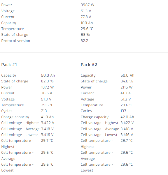

Hi there
I had to load up the beta version of the software for everything to work - without the beta you dont get the option to select the Dyness protocol as per the instructions in your link.
https://solar-assistant.io/help/updates/beta
My Dyness BX51100 communicates perfectly with SolarAssistant
Also remember to set your dip-switches to down on down down.
