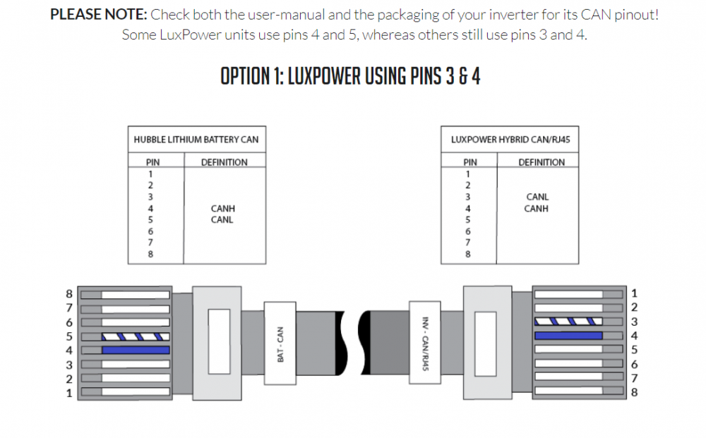

October 23, 20223 yr you need to make up the cable. Standard ethernet cable will not work, https://www.hubblelithium.co.za/luxpower
