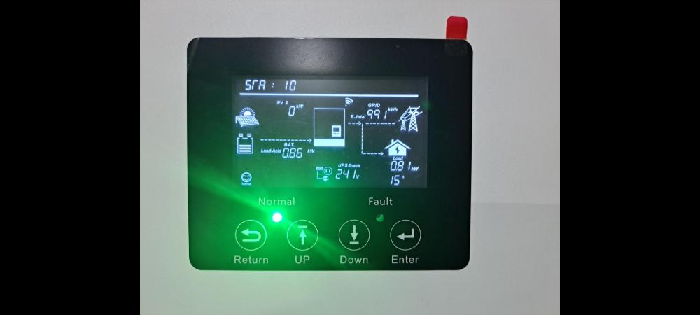

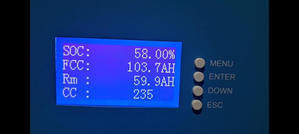

I have the exact inverter and battery installed with panels. My FCC is 103,7AH and stays like that. Only SOC and RM will change as you consume energy from the battery. The arrow from the inverter will come off the house and eskom icons and show on UPS during loadshedding. See my images from the battery and inverter screens.
Not sure what you meant by "Eskom should kick in when a certain voltage is reached."
