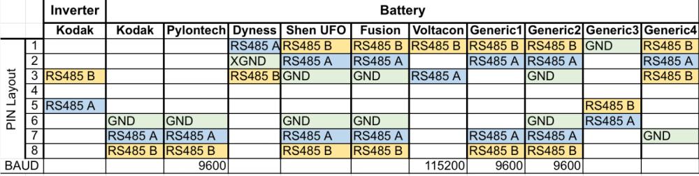

December 12, 20223 yr Author Hi Firoz, Nothing official yet. My Dad has been doing some testing on the pins with an Arduino Oscilloscope and there appears to be pulses generated on pin 7 and pin 8 of the RS485.
January 13, 20233 yr Author Hi Alif, With all the load-shedding of late we have not done much more testing besides confirming which pins have a signal on them. What we found was signal on pin 1,2,7,8. Basically like most of the battery layouts attached.

July 22, 20233 yr On 2023/02/02 at 3:02 PM, CoenieF said: Good day Does anyone have a Growatt inverter and a N Energy battery? I would like what pin configuration to use. Hi CoenieF, If you have 1 inverter and one battery, you can use a normal computer network cable (i.e. straight-through cable). Plug one end of the cable to the BMS port on the Growatt and the other end to the first RS485 port on the N-Energy battery. Then set your inverter to Lithium by changing "Program 5" to Li. That is working for me. The inverter is communicating with the battery and getting it's correct voltage and SOC levels. The challenge I am having to connect multiple batteries together to the inverter. As soon as I connect a BMS cable between the two batteries, the inverter reports BMS communication error and cuts off the power. I am guessing that the pinout of battery to battery BMS connection is the problem. A straight-through cable doesn't work on this case and I am not sure where to find the cable that can work. Anyone please help.
