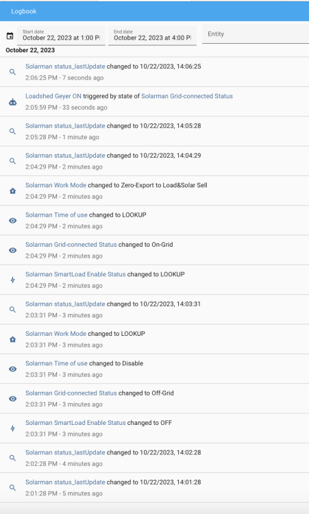

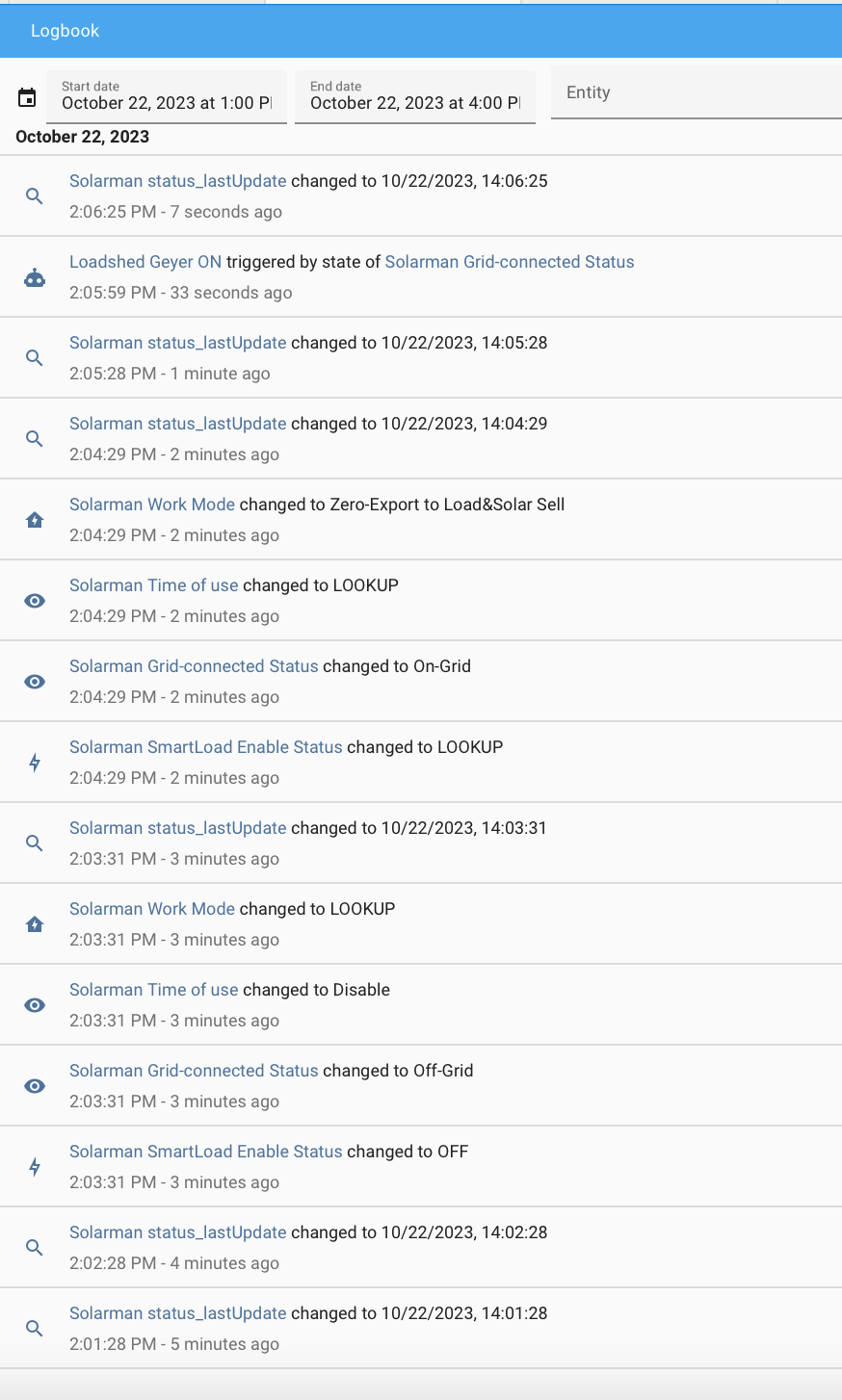

My inverter is going off-grid intermittently and was wondering if anyone has any clues or could help me think in a direction that could cause this. Also there is no load shedding close to the event and I only noticed this as some automations were running way to frequent thinking that load shedding is starting as I use the off-grid state as a trigger.
The pictures are from the logger that is tied directly into my home assistant.
On the below pictures the Grid voltage spikes to exactly 1285 Volt and grid power is exactly 5898 Watt. This is strange for as each time it happens it is that value every time. If this value is true I cannot imagine that it will be good for the longevity of the inverter.
