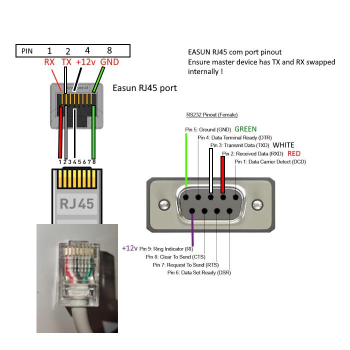

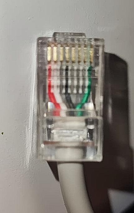

I have collated the Easun RJ45 pinout here into a diagram for future reference. The master device needs to internally swap TX and RX in order to communicate to the Easun inverter.
