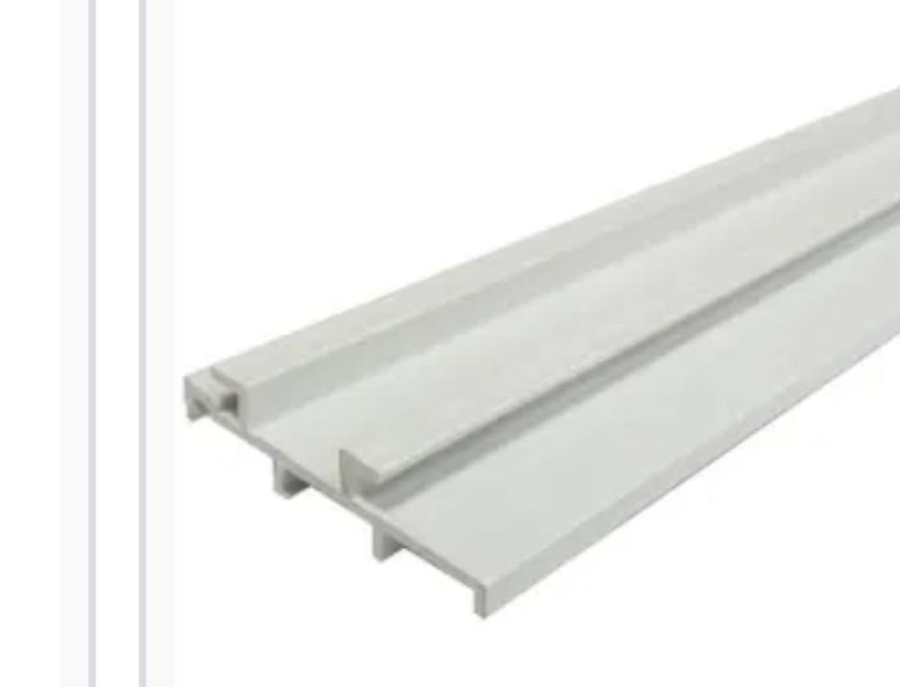

I need to fit a 2 pole DIN rail contactor into a samite DB board. The samite to DIN adaptor does not work as the din rail contactor has a weird notch at the back as per the below photo and this gets in the way when using the samite to DIN adaptor.

What is the current rating of the contactor?
Get this type of adapter.
Its a 25A contactor.
Where could I buy such an adaptor from?
