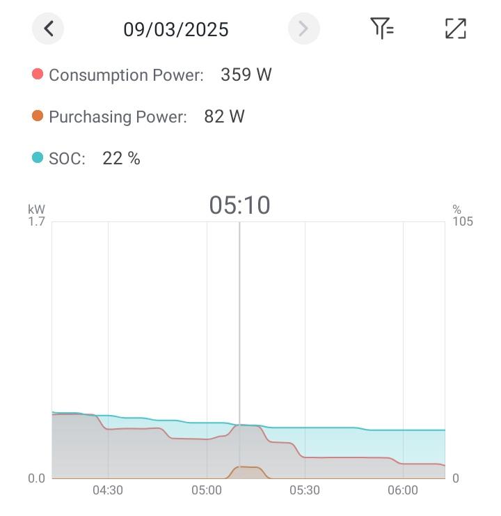

March 9, 20251 yr I am also using Volts and low batt and shutdown around 47.5V.I have also had a few shut downs when my timer setting to start using grid was too close to these settings. That caused a single surge load like a fridge to drop to these levels. Since using my timer activated from 23h30 up to 07h00 at a 50V level it works fantastic to feed in grid at a low level just to keep at this 50V level. Now I find it only uses the always from grid 50W most days and only a 30min grid charge below 100W while my total load is around 380W of which the self use power is about 68-80W. This is used at 05h30-06h30 for the mentioned 30min when PV starts kicking in. This grid use of 100W only takes place if we had weak sun and battery did not charge to 100%. The SOC is then around 20% +. Edited March 10, 20251 yr by Scorp007 Added pic
