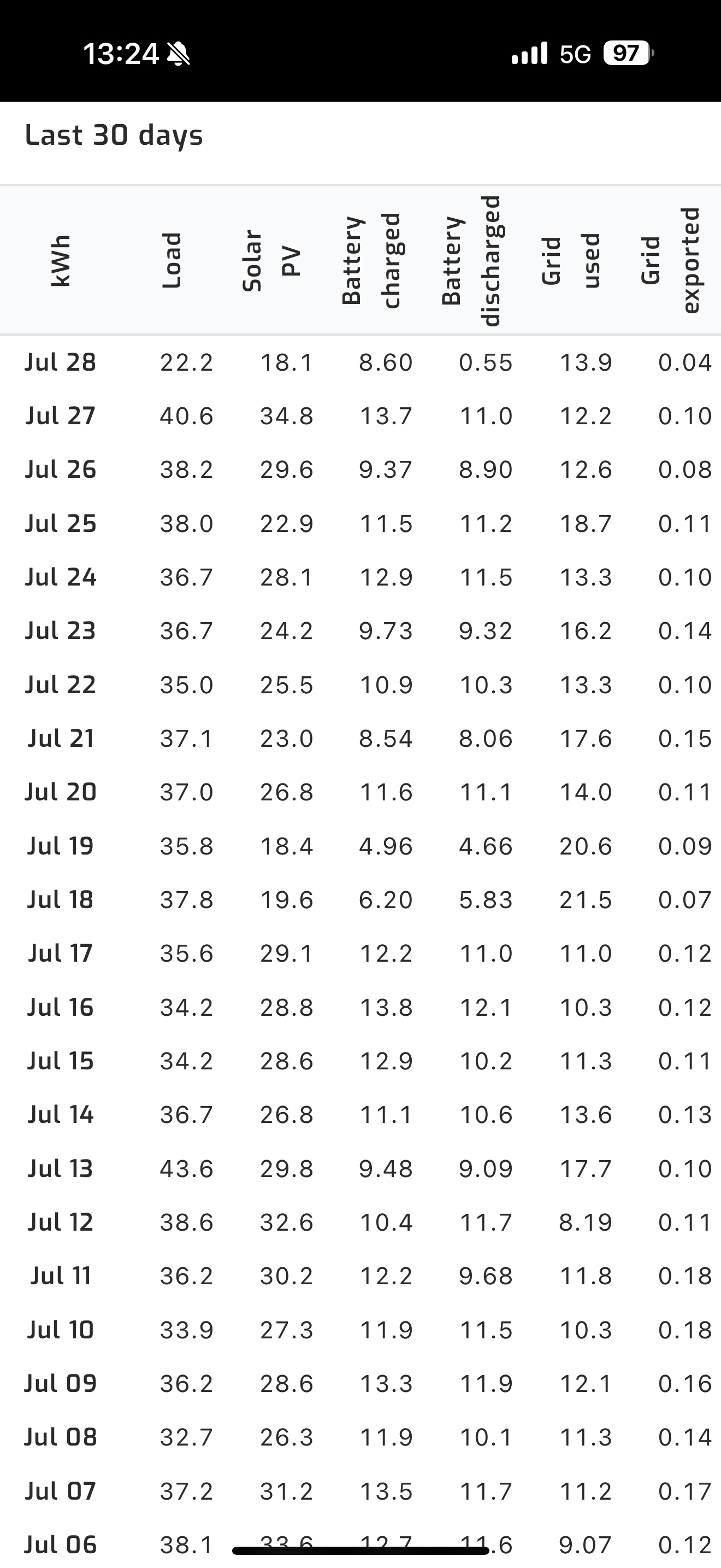

So I’ve noticed an increase in the Grid Export per month over the last few months. System Mode is currently set to Zero Export + Limited to Home and Priority is Battery has always been this way.
Timer settings are 50% battery across all slots and Grid Charge is only selected for the 01:00-05:00 and the 05:00-09:00 slots. Was setup like this to cater for LS predominantly.
Current Inverter FW version is: M 3.3.8.6 / S 1.5.1.5 / C E.4.3.D
You will see the export to grid figures reported by SA, which shouldn’t be the case.

Well that's exactly what I would prefer is absolute zero-export. I've heard/read in other posts that if your meter is not designed to accept grid-export then it just runs your units down. Now in my case its a hand full of units a month.
So hoping for some feedback from the people who are using this setting to give us both an answer on this :-)
