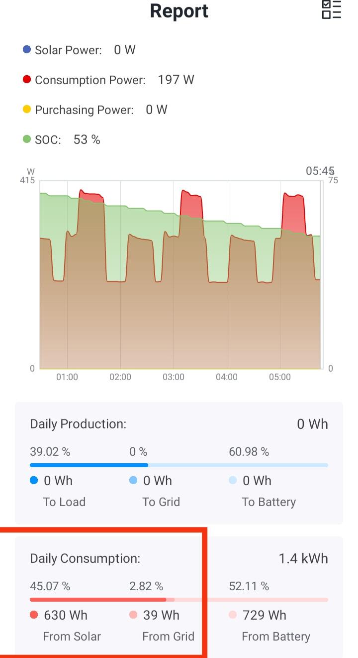

Solarman hit a pot hole 26Aug
From this one can see how Solarman read 630Wh from PV in the time 0h00 to 05h45. My panels only generate after 06h20.
Also my Grid was off so impossible to have used 39Wh grid. Prepaid meter confirmed no use took place.
The total consumption of 1.4kWh from 0h00 is correct but all from battery. Battery discharged from about 74 to 53% during the early morning.
