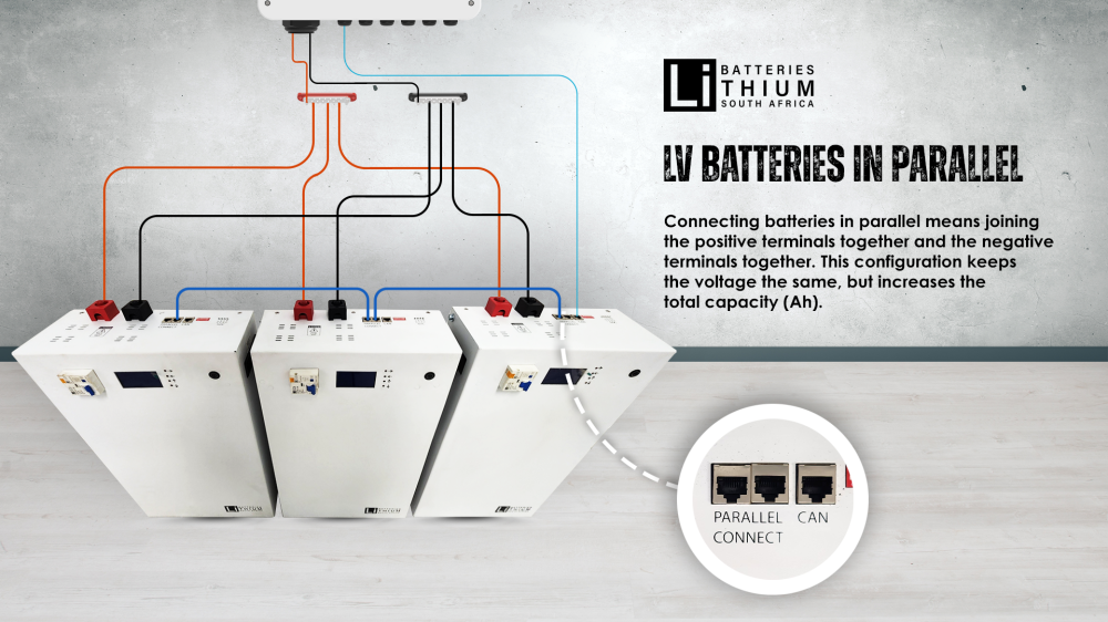

Connecting batteries in parallel means joining the positive terminals together and the negative terminals together. This configuration keeps the voltage the same, but increases the total capacity (Ah).
Example:
2 x 48V 100Ah batteries in parallel = 48V, 200Ah
3 x 48V 100Ah batteries = 48V, 300Ah
This setup is ideal when you want to increase storage time without having to upgrade you inverter.
