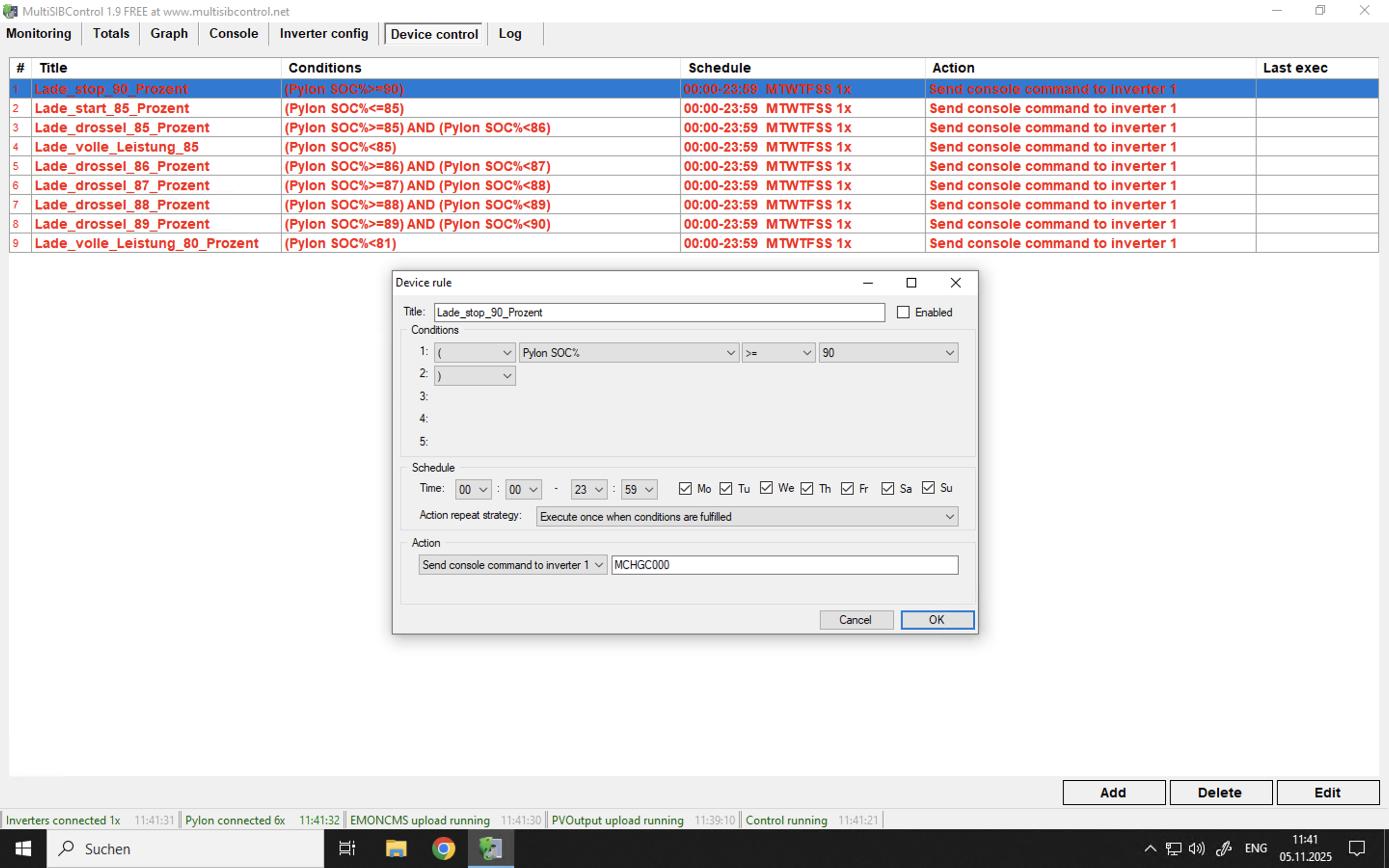

I am using MultiSIBControl to manage my Axpert Max II Duplex 11KW inverter in conjunction with Pylontech batteries. Communication between the software and the inverter generally works (receiving (ACK confirmation in the console), but I am encountering issues with the implementation of SOC-dependent charge current limitation.
The control objective is to achieve a gentle, stepped charging of the Pylontechs in the upper range (Hysteresis 80% to 90% SOC) while keeping the AC charging permanently deactivated.

    2. Implemented Control Logic (Stepped Charging)
    I have set up a precise, non-overlapping chain of rules to control the total charge current:
    SOC Range
    Rule Title
    Action Command
    Action Repeat Strategy
    < 80%
    Lade_volle_Leistu_80_Prozent
    MCHGC090
    Execute once
    85\% to < 86\%
    Lade_drossel_85_Prozent
    MCHGC045
    Execute once
    89\% to < 90\%
    Lade_drossel_89_Prozent
    MCHGC025
    Execute once
    >= 90\%
    Lade_stop_90_Prozent
    MCHGC000
    Repeat every 1 minute
3. Observed Problem: Momentary Charging/Flickering
The issue affects both the 0A Stop Rule and the Throttling Rules:
  1. On Charge Stop (SOC≥90%):
    • MCHGC000 is sent, and the charge current briefly drops to 0A (ACK confirmation received).
    • Within < 60 seconds (before the next repeat command arrives), the inverter ignores the 0A command and increases the charge current to an internal default value (approx. 50A or more).
    • Since charging resumes, the condition SOC≥90% remains fulfilled. The MCHGC000 command is sent again after 1 minute, the current drops to 0A, and the cycle immediately repeats (flickering).
  2. During Throttling (85% to 90%):
    • The throttling commands (e.g., MCHGC045 at 85%) are also only implemented very briefly.
    • Shortly after sending the 45A command, the charging jumps back to the internal default value (approx. 50A), undermining the fine-tuned throttling.
4. My Question
Is there a recommended "aggressive strategy" in MultiSIBControl for this known issue (overriding of external MCHGCnnn commands by the internal firmware/BMS logic)?
Should a Mode Change command (e.g., PSB) be used in the Lade_stop_90_Prozent rule to inhibit the WR's charging function at a higher level, thereby resolving the flickering? If so, which mode commands are recommended for "Stop Charging" (at ≥90%) and "Re-enable Charging" (at SOC<80%)?
Thank you in advance for your support.
Rafa
