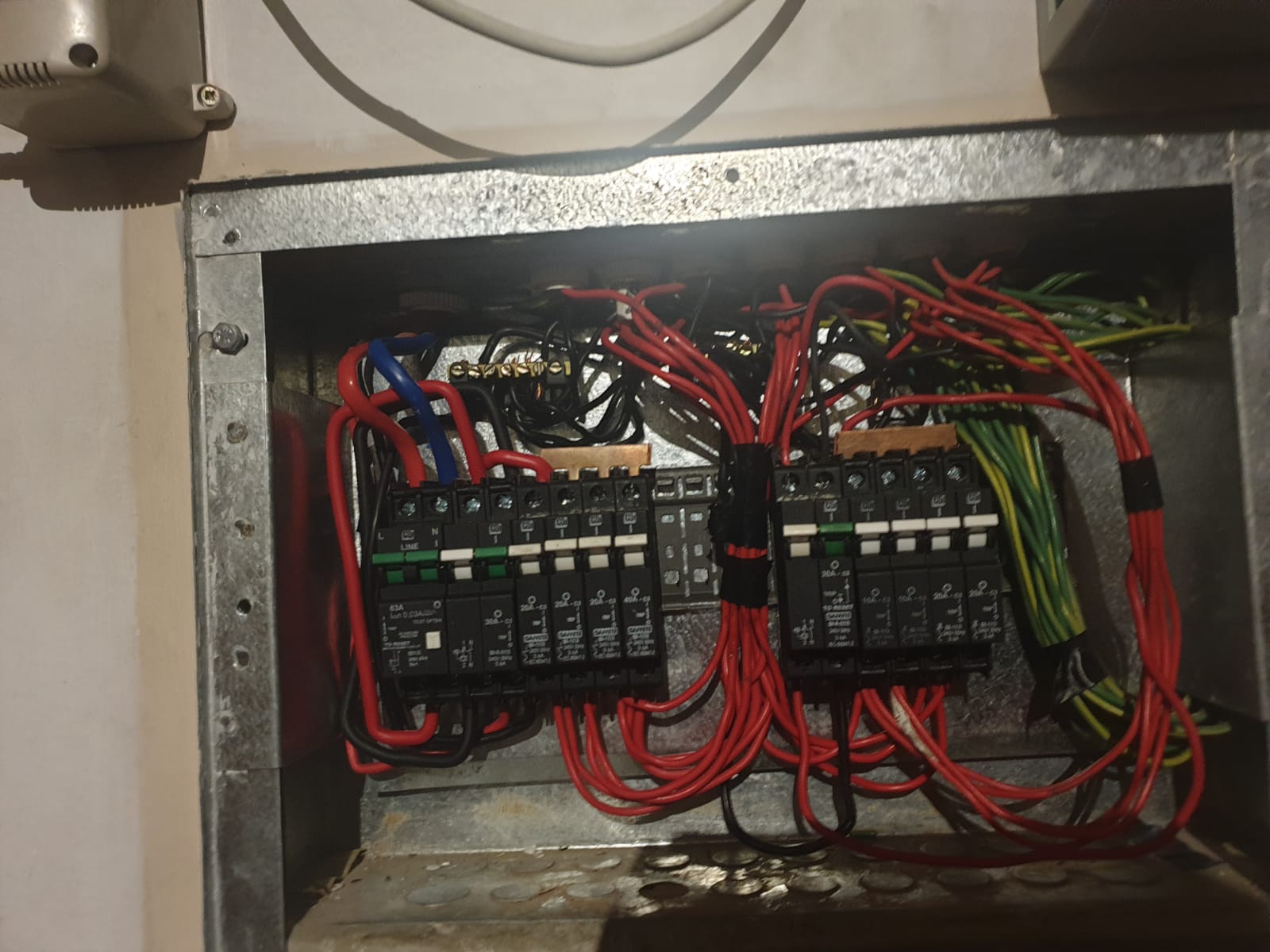

Thanks to the advice received early on, my 3 DB boards.
This is what my final inverter panel board turned out like
DC Distribution box
Final Install before I start closing up and labeling
