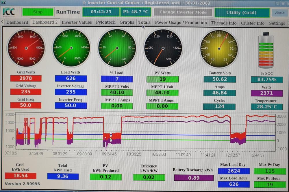

My setup has started behaving strangely, alternating between bypass mode and battery mode every 10 seconds or so. I have tried shutting down completely to reset the inverter chargers (they have no alarms present), I have also disconnected the Raspberry Pi to see if that was causing the problem. I have tried forcing the system into bypass mode using the inverter settings, and I have tried switching off one inverter at a time to see if one of them is faulty. I am assuming the Inverters are faulty, and I will replace them during the week, but are there any other suggestions please? I am attaching a photo of the Dashboard, you can see where the inverter is short cycling. There is no sun today so I am charging the batteries with Utility in case the power goes out.

Can you please post screenshots of your battery settings and inverter settings tabs from ICC please? Just to ensure that this is not caused by any conflicting settings?
And what Axpert models and batteries are you using?

I think I know what causes the behavior: Did you manually change your system to Utility? If you want to manually change to Utility, then you first need to disable the 'Use SOC for Control' on your battery settings tab (and then press the 'Save' button at the bottom right for ICC to accept the new setting). Otherwise ICC (after a few minutes) switches your system back to SBU because it picks up that your SOC is higher than your set value and triggers the switch.
Could you please make the following changes and see if your system behaves as desired (if I understand correct you want to run on Utility and charge the batteries from both Utility and Solar - correct?):
  1. Disable 'Use SOC for Control' on battery settings tab
  2. Set 'Back to discharge voltage' to 58V (or whatever else the highest voltage is that you can set - to ensure that the Axpert itself does not interfere with the ICC switching)
  3. Set inverter mode to Utility (in case ICC has switched it to SBU)
A few further setting changes that I would recommend:
  1. 'AC Input Range' to 'Appliance'
  2. 'Bulk charging voltage' to 52.5V (see more details on why these values see this thread)
  3. 'Float charging voltage' to 51.8V
Thank you the settings seem to have worked. The Inverter settings on the ICC Program seem limited, it will not let me change maximum charge rate and cutoff voltages, but otherwise I can do it from WatchPower and everything else seems to have come right. Do you know which is the best of the lower priced Hybrid Inverter Chargers are? I see Kodak, Growatt, Deye, Goodwe, Sofar to name a few. I am happy with the performance of the Axpert ones, but am worried about long term durability.
