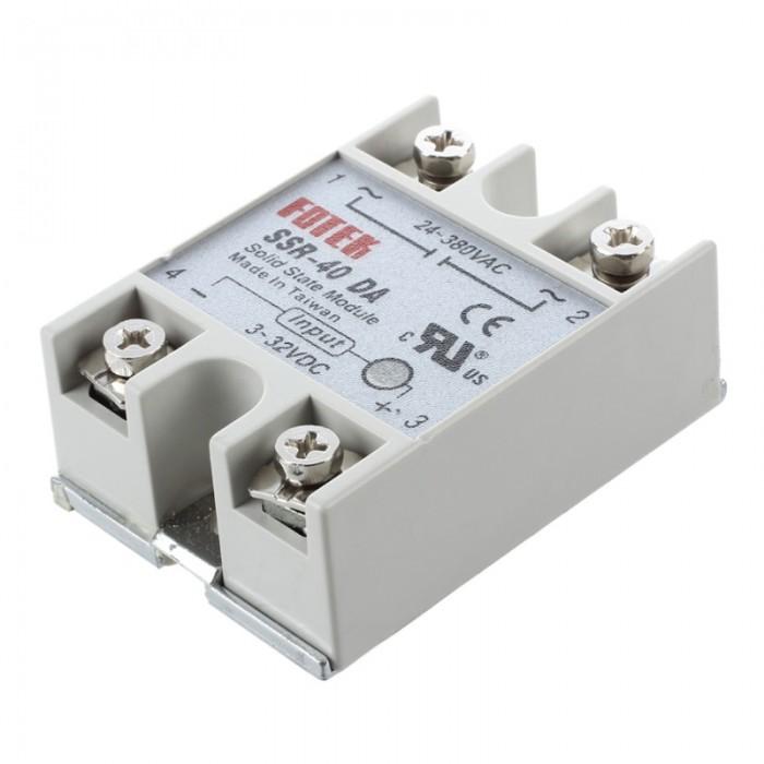

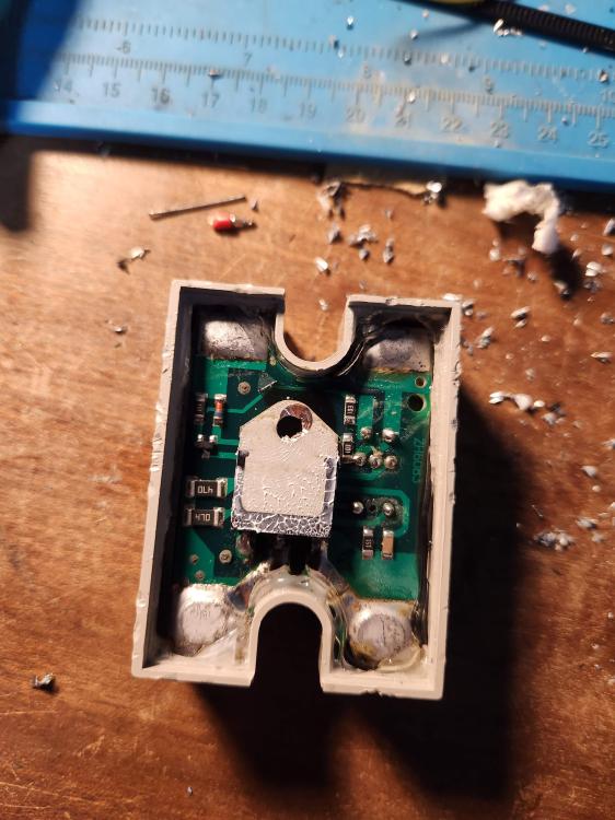

17 hours ago17 hr Went down this road recently. Worth keeping in mind that most SSRs sold locally are fakes, specifically fotek fakes. See: https://protosupplies.com/inferior-counterfeit-fotek-ssr-25-solid-state-relays-on-the-market/I recently purchased from a local supplier (I don't blame them, I expect they weren't aware - I'm just trying to point out that we are likely not buying real/properly rated SSRs here), and it was sold as a "SSR-60 DA", implying 60A rated switching current. After realising this is likely not a real fotek (no datasheet available for this alleged model from fotek, which is a reputable brand), turns out its got a 40A BTA41 1000B triac inside, which in all fairness is way better than what I expected given that its absolutely not a legitimate fotek SSR. Just know what you're getting. Given these tend to fail closed, I'd never trust a locally sourced SSR after this.
