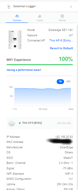

Some comparatives here
Solar Assistant - providing 1s realtime data via MQTT to my home Assistant instance so lots of data. Also includes downloads of new firmware that i did  - 452Mb
Comparatively - Solarman providing the standard refresh interval to the cloud - 668kb
