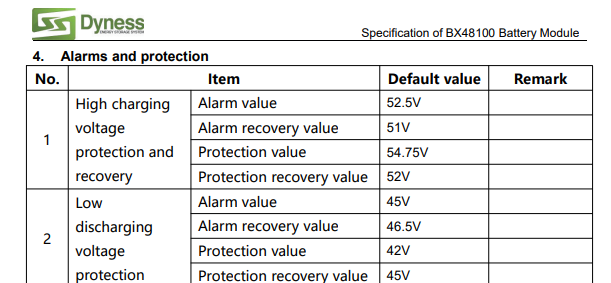

Not sure which Dyness batteries you have. So when I look at the datasheet of this particular Battery, your program code 19 and 20 are a bit higher than what the battery specs state.
himage.png.5602b2680aae0f70900ef7d09aa8c761.pngttps://solaradvice.co.za/wp-content/uploads/2021/12/Dyness-4-8-Block-Datasheet.pdf
Did you just leave the Inverter values at default?
The next question is if there is no BMS comms possible with those batteries?  Do your batteries have a sticker that states the charge and float voltages?
If you do not have BMS comms, then read program code 5 again. "US2 (suitable when Lithium Battery without BMS comms)
Have you tried that yet and applied the correct voltages in 19 and 20 as per your batteries specs?
