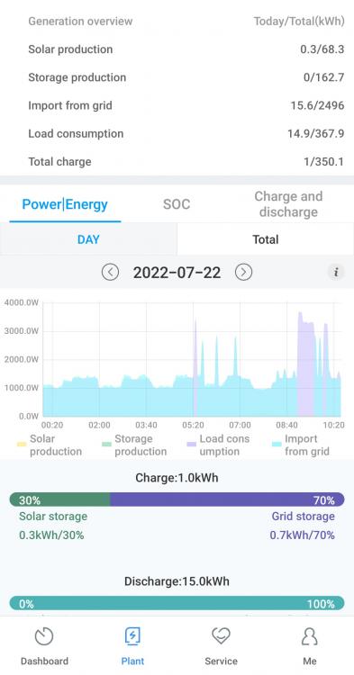

July 22, 20224 yr Author Just now, JacquesBrittz said: This is my status at the moment as per my phone App.
July 22, 20224 yr 27 minutes ago, JacquesBrittz said: This is my status at the moment as per my phone App. @JacquesBrittz I don't see any solar production on your dashboard, something is very wrong, you said you have 4 X 540 W panels, at 10 Am you should be getting close to 1500 W of PV power.
July 22, 20224 yr Author 6 minutes ago, Antonio de Sa said: @JacquesBrittz I don't see any solar production on your dashboard, something is very wrong, you said you have 4 X 540 W panels, at 10 Am you should be getting close to 1500 W of PV power. Yes, I agree. I think I should get the guy out again that installed the system.

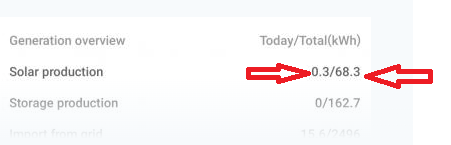

July 22, 20224 yr 35 minutes ago, JacquesBrittz said: This is my status at the moment as per my phone App. Once you post your settings, we could maybe see if it is settings related. Looking at your data, you have had solar production in the past. The values you see here are 0,3kW for today and then the 68,3 is the total production to date.
