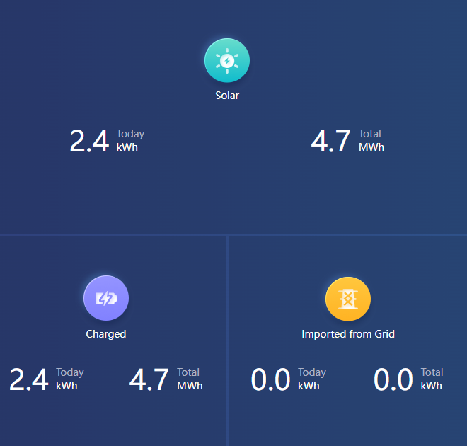

Their PC app is full of mislabeled data.
The Phone App at least doesn't have the same amount of errors,
My inverter is truly off-grid. The header "Charged" contains my daily and total Solar, i.e. the same data under different labeled headers.
Thats why I use SolarAssistant to get a better overview.
Ok cool at least yours is also wonky so its something their end and not mine :D SolarAssistant is the raspberryPi thing right?
