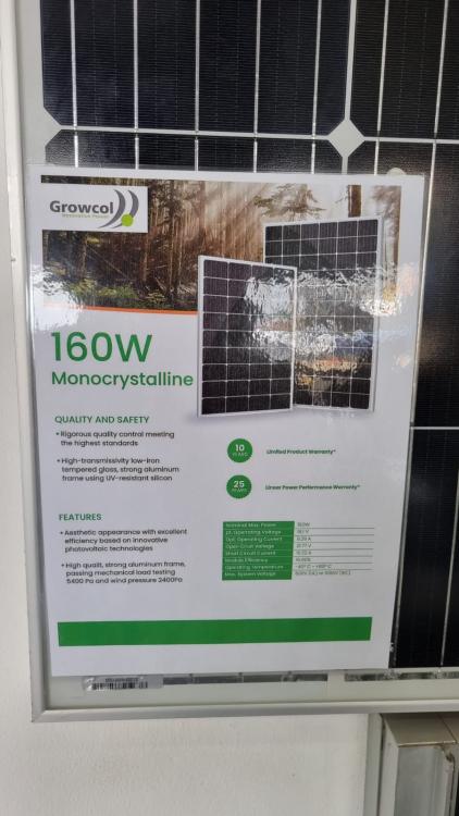

November 15, 20223 yr Author 2 hours ago, iiznh said: A solar panel will work fine as long as you draw from the power curve where the voltage is high (which is dependent on the amount of light). The moment the power draw is too much the voltage will fall. That said you will probably struggle in cloudy conditions. A charge controller provides a (semi)constant voltage (with the help of a battery) but variable current. You could probably get away with a small 12V battery used in gate motors. PWM charge controllers are fairly cheap especially if you buy a small one with 20A output HI, I understand the solar panels dont work with Cloudy conditions, for the time being its just going to be an Emergency power supply for my power station and or Laptop. To reduce the Amps in I can just use a Resistor on the Solar panel side to reduce the solar amps out? Regarding the gate motor batteries, I need 18/20v out, they only 12v, so I will then need 2 in series? I have 3 spares in good condition here. I dont understand what you mean by this: "as long as you draw from the power curve where the voltage is high". I also noticed theres these specs: Optimum Operating Voltage (Vmp): 18.21V. Optimum Operating Current (Imp): 8.79A. Open-Circuit Voltage (Voc): 22.39V. Short-Circuit Current (Isc): 9.529A. I assume I need to work with the "Optimum Operating Voltage". As I need a 20v output for my PD Charging, I will most probably need a Solar panel with an Higher than 20v Optimum Voltage? Or can I use a Buch Boost controller to boost the volts from the 160w panel to get my 20v? Theres plenty of spare amps, I will need a max of 6A between the 2 outputs? Im looking to get the following Buck converters: https://www.mantech.co.za/ProductInfo.aspx?Item=15M3540-A Its for a fixed 3A output with a variable voltage. I should be able to boost from 18.21V - 20v with this one? And https://www.mantech.co.za/ProductInfo.aspx?Item=14M2243 Down to 18v 3A to the other? Solar Panel Output 18.21v: (Not sure if I need a resistor also to limit the current to the converters) * Output 1: Buck Boost Converter --->20V 3A ---> USB PD Charger * Output 2: Buck Step Down Converter --->18V 3A ---> Power Station The USB PD Charger says it can take from 12-24v in, so Im just going to use the buck boost converter to limit the current to 3A, dont think the charger will take good with a full 10A input? Edited November 15, 20223 yr by Hardusb
November 16, 20223 yr 22 hours ago, Hardusb said: I dont understand what you mean by this: "as long as you draw from the power curve where the voltage is high". Look at the voltage current curves of a panel To express it in a better way, you need to draw little enough current to avoid the voltage to dip (which is what a PWM charge controller does). I would get a 20A PWM charger because you might just find the next thing you would like to charge too, they are like R250 ballpark. That should allow you to use the panel most hours and even in cloudy and rainy weather The PWM charge controller gives you a constant voltage with a variable current, paired with a battery as buffer you should be able to run your setup with your batteries in parrallel and charge them with 14.4V and float them with 13.8V. The currents are small enough that 12V will work for your application Use the load output on the charge controller to connect the DC/DC boost converter to charge your "power station" with 18V3A and use a standard 12V car usb charger with PD that should be able to power your laptop. Also worth to note that your laptop will only pull 65W when recharging the battery, most laptops draw 10-15W with day-to-day work so a smaller than 65W should be fine And no a resistor will not work, it will act as a voltage divider, consume energy and heat up
November 16, 20223 yr Author Thanks for the advice. I watched this one YouTube video where the guy puts a 300w buck boost converter between the solar panel and the pwm controller, says its a cheaper way to get the same effect as a MPPT Controller, The max I would draw from the panel would be about 6A, it supplies 10A. Will the 160W work or must I get a bigger one? Which Model controller do you suggest? Hows the Ecco ones the Chinas sell? Any good? I saw the attached one at a Solar shop for R1700.
November 16, 20223 yr 2 hours ago, Hardusb said: Will the 160W work or must I get a bigger one? Which Model controller do you suggest? Hows the Ecco ones the Chinas sell? Any good? Personally I would rather look for a 330W or similar panel. Many more watts for the same money. That way you will have almost enough current even on rainy days Sorry link I provided was to sold out panels.... seems like loadshedding killed all stock Personally I prefer to stick to well known brands like JA/Canadian Solar A 10A panel will yield 10A on perfect conditions, most days you will see 8A (between 11 and 2), early mornings you will get anything between 1A-6A My dad runs an ecco controller in his setup, they do work fairly well. F or a budget application they are perfect, they waste some energy (like every other PWM) but they are cheap and sometimes that is more important. Edited November 16, 20223 yr by iiznh
