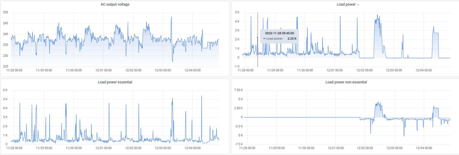

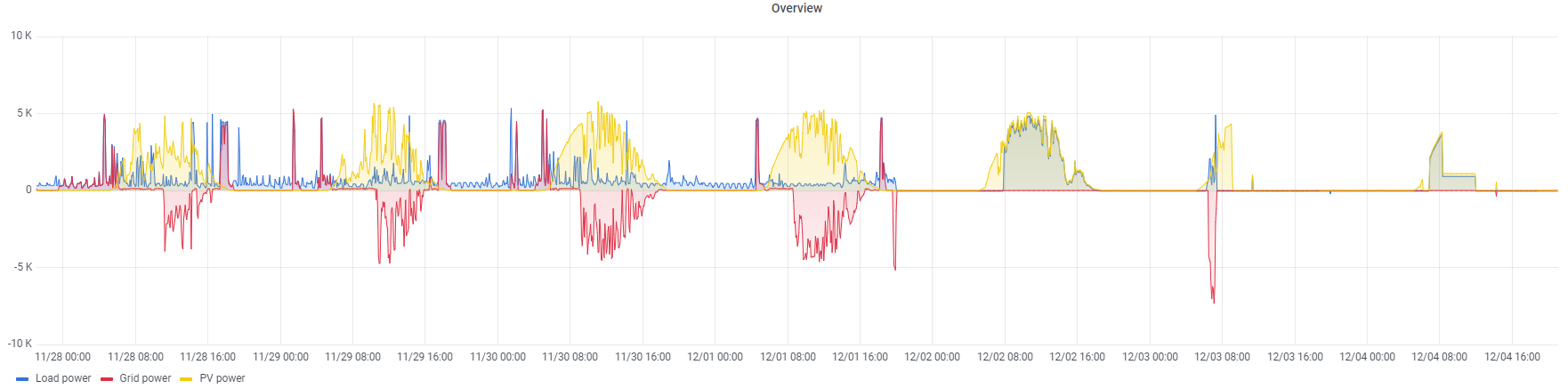

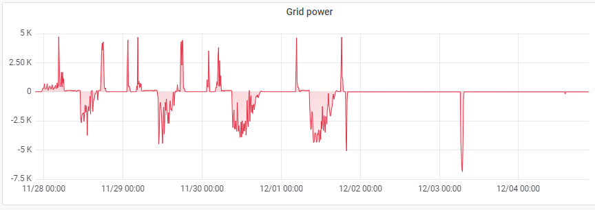

I've had a new install done and notice that I've been sending power back down the grid. I'm using Solar Assistant and get and set inverter values in Home Assistant via MQTT. When I realised what was happening, I tried to the Solar export when battery full value via MQTT.
You can see the change in values since doing that on Thursday night.
The only Grid values I see are negative ones if I allow solar selling.
And it appears as if the true grid values are now being read as the non-essential values albeit inverted.
Does anyone have any clue what I've done here? I have tried to restore the settings and reboot the inverter to no avail.
Thank you for your time. Sincerely, I appreciate any assistance with this.

I've finally found it. Thanks to the response in this post.
It appears the integration into Solar Assistant set Limit to Load to false (unchecked).
I needed to check this again and all is reporting correctly.

Note: I'm not familiar with the bottom-right graph you have - I've not seen one like that on the SunSynk - so it's not clear to me what it means exactly. But it does seem odd that it shows negative values. It might be telling you that you've already done what I will suggest below...

The graphs come from the Raspbery Pi connected to my inverter running an application called Solar Assistant. The terminology that you're using is the same as what I've seen on the Deye inverter.
What you've mentioned here, makes me think that the CT isn't in the correct location - it was all done by the trusty installer. If I uncheck "Limit to Load", I end up with the odd readings and inverted non-essential usage.
