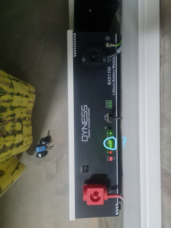

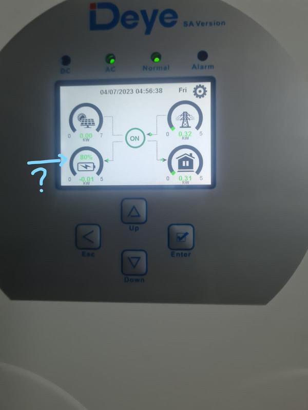

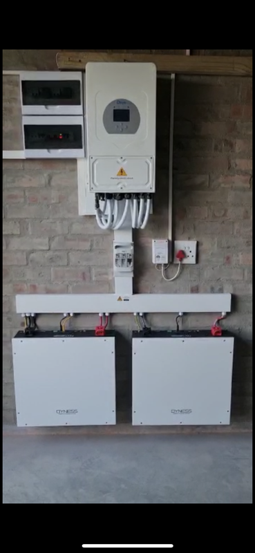

Hello,
I had a system installed few days ago. Deye 5KW inverter and 2x Dyness 5kw batteries. Panels coming when they eventually get stock.
I have a few questions to those who know more than me about these things:
1. The installer said the system is set to only discharge the batteries to 30%. Is this normal?
2. The batteries never reach a full charge? They get to 80% of max capacity and then stop charging? Surely this is not normal. See attached pics. Is this a setting on inverter causing this or faulty batteries? Or is this normal?
So, if the system is set to only discharge the batteries to 30% and only charge to maximum 80%, that means I only get 50% usage form a battery? What's the point of Lithium then, as this is the same % I can get from cheaper lead-acid, no?
Feedback or input much appreciated.

Maybe the inverter has been set to only charge to 80% SOC during certain  time slots and then to only discharge to 30% SOC during other time slots? As you have no PV this is actually pretty easy to set.  Post a picture your system work mode. Something like this

That last image does you everything you need to know in terms of max charge. Because you don't have solar, once the batteries get below 80% they are charged up again up to 80%. If you had solar it would push all the way up to 100%
Since you want a UPS you can untick time of use. It will keep your batteries at 100%
