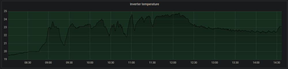

It would be better to put a secondary fan on the outlet side of the inverter to "suck" the air out, thereby reducing the temp and keeping the noisy fan quiet.
I just added a pc fan on the outlet, but it is unfortunately driven by a 220V step down to 12 V DC power supply which I put on a timer, from 9am to 5pm daily. Problem solved. The new fan is quiet and solved the problem.
