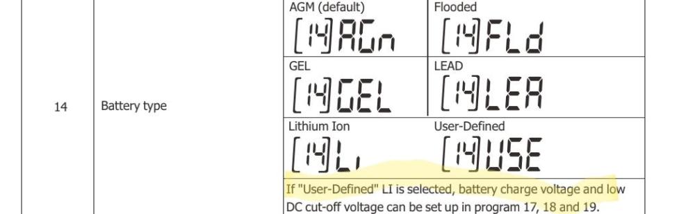

Please note that in order to set the voltages, you need to be on USE battery type, not LI !
See the comment in the manual for USE battery type.
Otherwise the inverter will use predefined voltages, which might not be optimal.

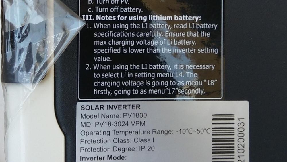

The inverter has a sticker on the side of it saying one should use Li setting with a Lithium battery.

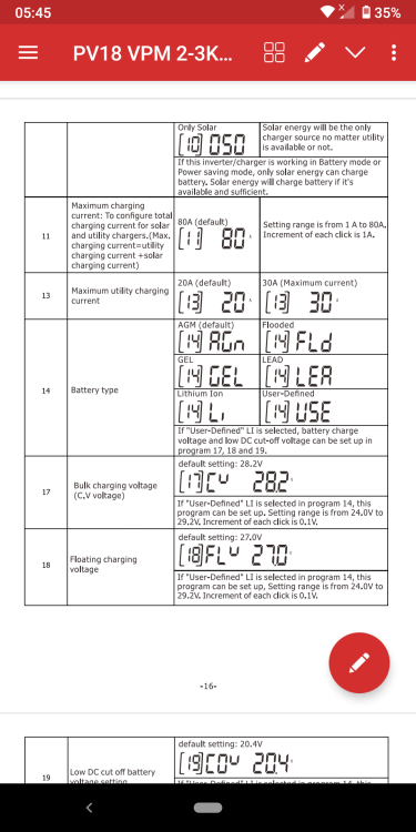

It says the charge voltage will go to float(18) first before going to bulk(17) which follows the Lithium charging algorithm shown later in the manual.
In Li mode I am able to set float, bulk and cutoff voltages

As I mentioned, this is counter-intuitive to the manual, but you're correct, it does work with LI settings.
