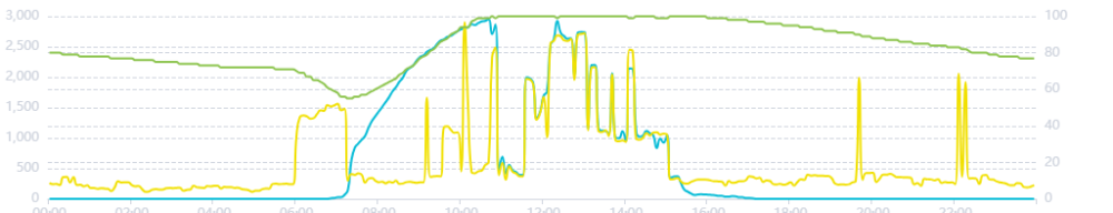

My system Friday just gone. Blue line is PV, yellow line is demand, green line is SOC
Soc is 80% at midnight. Load fluctuates between 120 and 300W overnight (fridges, security, exterior lighting). The big surge in demand at 6:00 is the heat pump (water heating turning on). I have 55% SOC when the heat pump turns off, and PV just starting to come on line. If it were an overcast day AND there was a 4 hour load shed at 6:00, I'd have a hot shower and 4.5 kWh left. OK... 3.5 usable kWh, but since the pool (non-essentials) won't start up, and I'm careful with appliances (I include the kettle in that) I have a good chance of getting through that load shed.
Note the yellow line between 9:00 and 15:00. We try to do as much as possible during the daylight hours, so that we know that we can stretch the battery a long way overnight.
I fully understand that it's not my money that will be spent 🙂, but 10kWh is worth considering, especially if you can control the loads after 16:00 or so.
