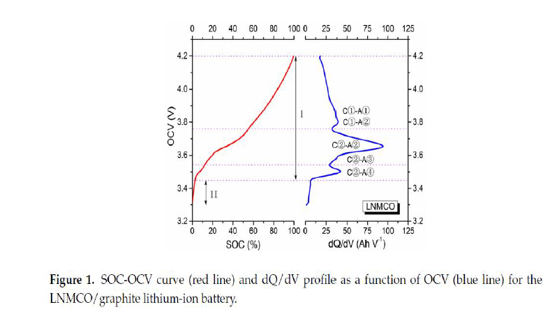

37 minutes ago, zsde said:
Here is the cell voltage vs SOC curve for NMC cells.
Don't you have a battery to SA connection to actually see the cell voltages?
https://www.mdpi.com/2313-0105/4/1/11/htm
