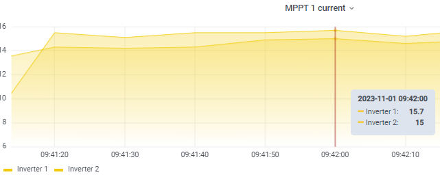

My panels are rated just short of 13A.  When these high peaks occur I have seen the Amps between 15 and 16A. The voltage doesn't change much.

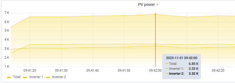

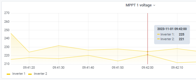

This is yesterday's peak at 6,85kW at 09:42. One string each feeding each Inverter.
The Amps went to 15 and 15,7 respectively
Voltage stays normal, in fact because of the load it actually drops slightly.

As indicated you can never get a voltage higher than Voc when the panels are not open circuit. That is the reason they give this voltage. As you draw more power the voltage will sag a bit. The higher the load at the same other factors the lower this voltage will be. Cloud edge will affect the voltage as the panels cooled down a bit while the sun was behind the cloud.

High output always goes with high amps and a bit lower volts.
