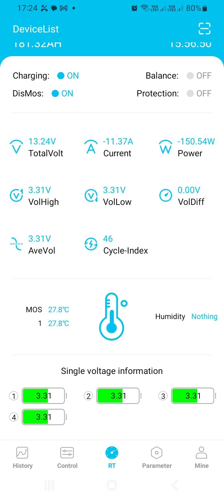

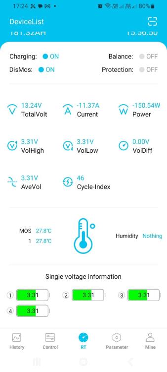

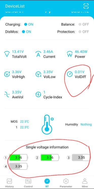

Not doubled each battery is contributing 17.5w towards the total load. Remember the 2 battery apps are seperate on the page you connect 1 at a time so it displays the 1 battery at a time. You should consider to get a smart shunt connected to the negative side of the load then you will read both batteries together. What is the 2 batteries cell balancing on both according to the app.
Screenshot_20231221_172456_XiaoXiangElectric.thumb.jpg.f1a784676908f7c2eaba7e4d0d85566f.jpg
@TaliaB Thank you for your assistance and explanation. I will definitely look at getting a smart Shunt after Christmas. I am not sure about your question regarding Cell Balancing, but I have attached screenshots for you that may answer it. In the screen Shots the batteries are now charging from Solar, so again I am assuming with one being 46w and the other being 38w, the total charge is 84w
