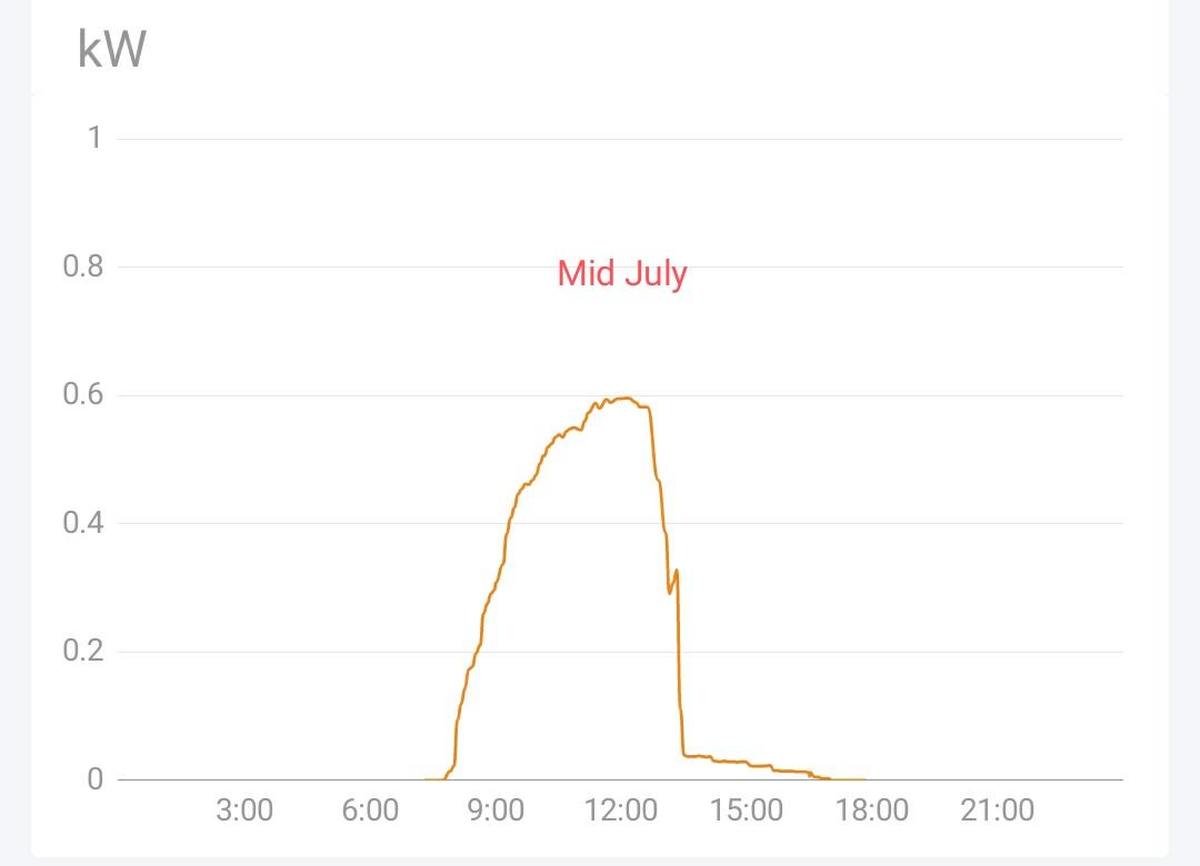

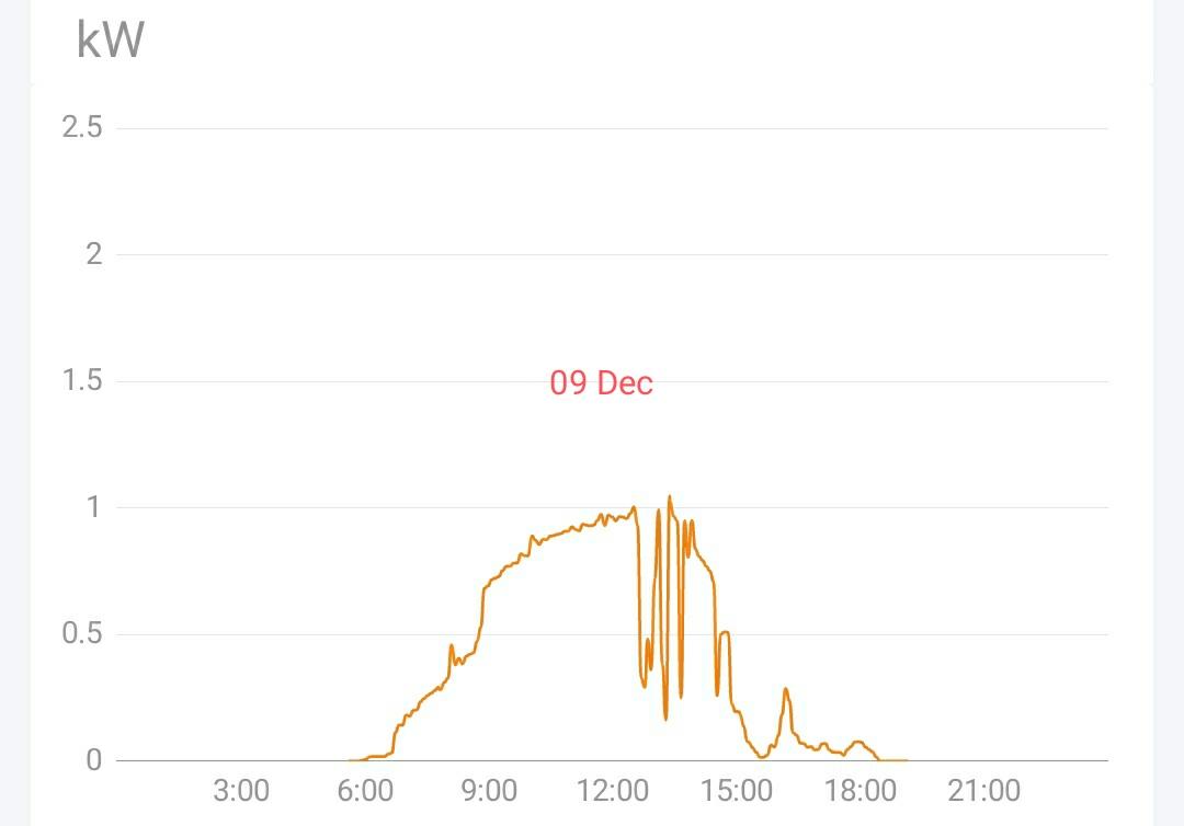

If you are interested I can supply the difference in yields up to 12h daily for you to see between summer and winter. Winter is a killer if you have no tilt.

Ignore after 12h00 as clouds set in on 9 Dec. In winter after 12h15 severe shade from a high side wall where my car port is located next to the house.
During winter I used a bracket to lift about 15 degrees and still the peak is only 600W and PV starts 08h00. If string was flat the yield would be even less.
During sunshine days in summer the peak is about 1000W and starts 06h00 at zero degrees tilt. Not many full sunshine days.
Values are for a 1320W string facing north.
