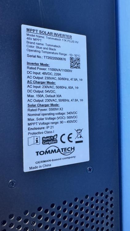

September 9, 20242 yr 42 minutes ago, Macarxp said: My device is TommaTech. The software you sent is Axpert. Will this cause any issues? Many of these inverters are rebranded Axperts; some are clones, a few are work-alikes. A quick search indicates to me that TommaTech are a genuine Voltronic rebranding, but I can't quickly find the label on the side that usually clinches this determination. Either post a photo of the label here (preferably with some screws and the small sticker with the manufacturing date also visible), or check Do I Own a Clone? if you'd like to me more certain. The photo I saw looked exactly like an Axpert E 11 kW model, and the 73.xx main firmware and y12.xx display firmware are correct for an Axpert 11 kW '28066 non-twin, so I think that there is little doubt that the indicated Axpert firmware will work.
September 10, 20241 yr 10 hours ago, Macarxp said: Is this exactly the photo you wanted? Yes. Interesting. The serial number is wrong, compared to what I'm used to, there is no barcode, and the QR code has only the serial number. But the rest looks totally legitimate, and sometimes bigger resellers are allowed significant variability of the sticker and serial number. I've now gone from 98% sure it's legitimate to 90%. So there is still a very good chance that updating the firmware will work. But if you don't like those odds, there is about a 98% chance that running with your existing firmwares should work. I recommend checking the voltage difference in the outputs before final paralleling, by putting one multimeter lead on each output. The reading should be well under 20 VAC, preferably under 5 VAC.
