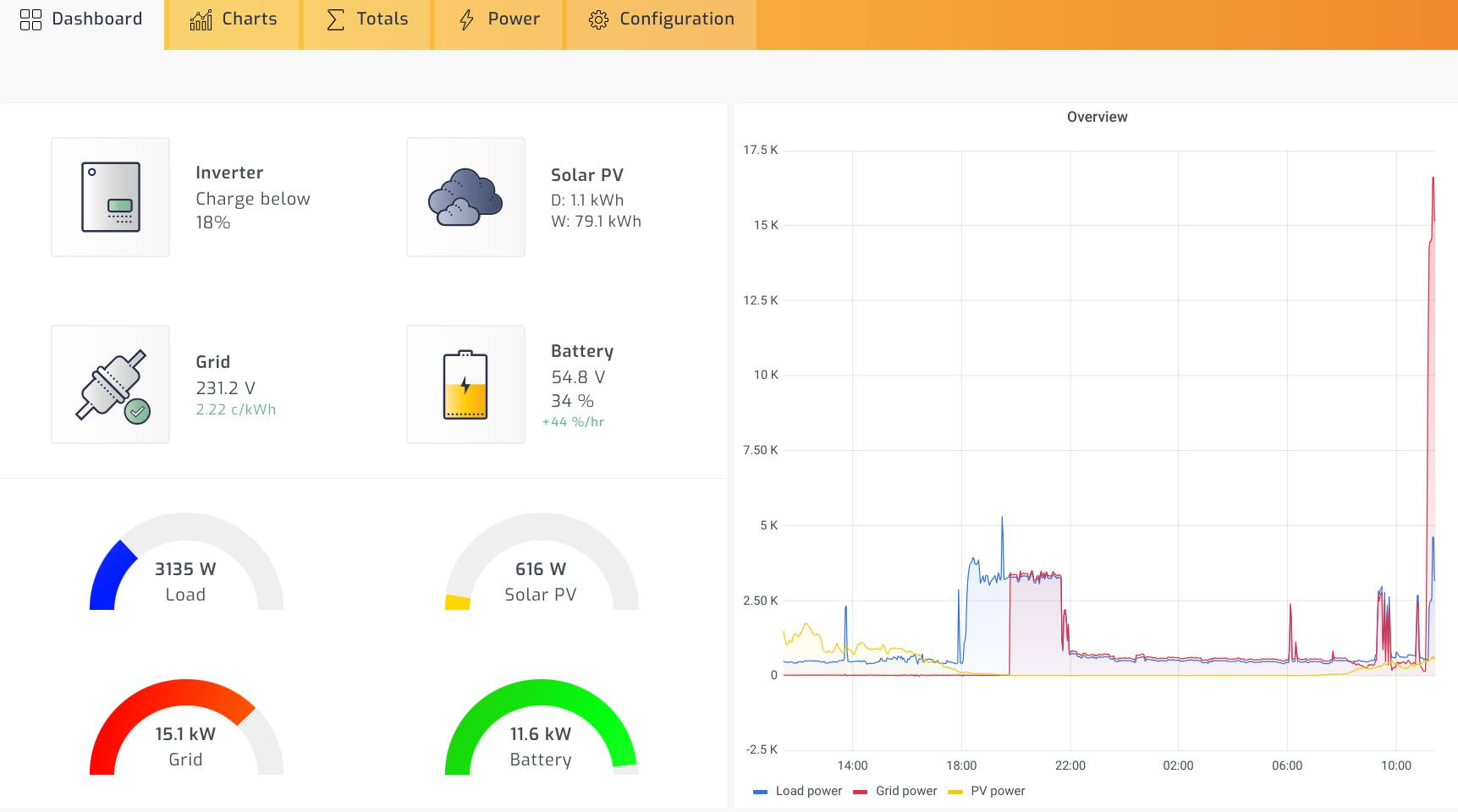

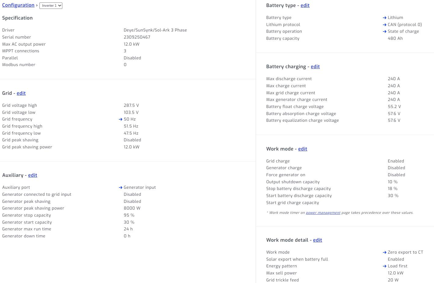

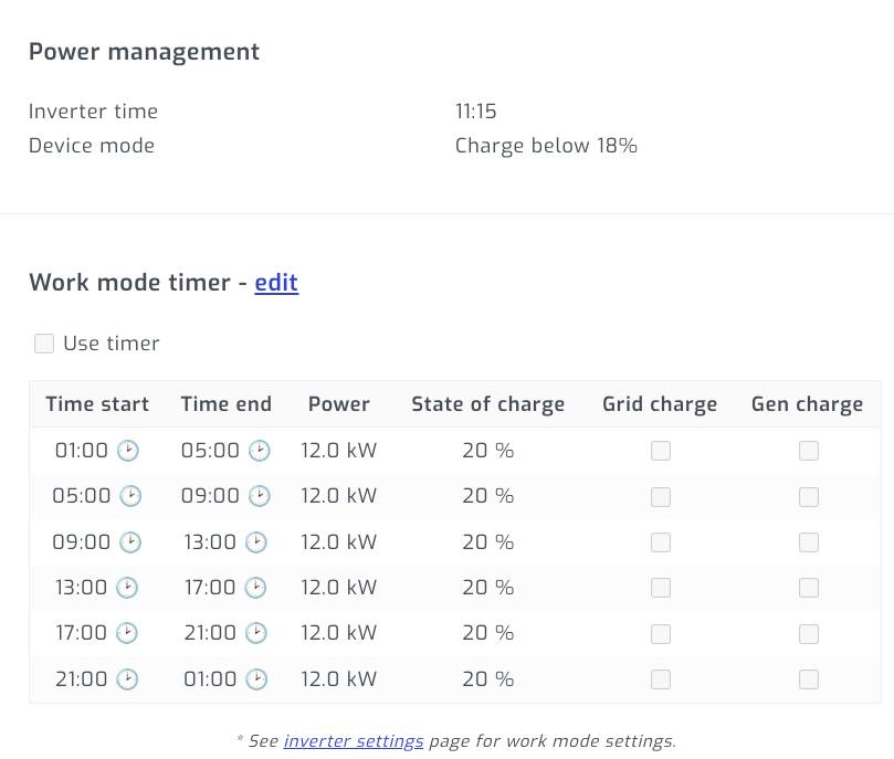

I attch my setting which currently work to charge from grid, having said "time of use" is disabled and I think that's wrong!?
As you can see also the weather is bad and battery stopped serving load last evening and switched to grid completely (which is fine) at 20% SoC. Now it's back at 23% after enabling grid charge and disablingn time of use...

Which is the time slot in which you want to charge the batteries from the grid?
Let's say the Tibber price is cheap between 01:00 and 05:00, then you need to tick the grid charge box against that time slot. Wichtig, you also need to set the SOC - State-of-Charge - in that time slot to a higher value like 100% if you want it to be charged full from grid.
Then for all the other times slots, the solar and battery will be used first, until the battery is drained down to 20%.

Hard to say the timeslot because this one Changes on a daily base and therefore there is no general way to setup timeslots on the inverter.
What I can do is to setup a timeslot between 11:00a.m.-05:00p.m. and activate the grid charge box and set SoC to 100% when tibber price was triggered.
Wondering if just disabling ToU tables and activating grid charge would be sufficient as well as it seems to have manually my battery loaded today.
UPDATE... MY BAD SORRY: Found it in the SolarAssistant MQTT Settings/Logs that there is a "Allow settings changes" option which was disabled...
Another interesing finding: I can change/edit any settings from SolarAssistant UI but can't change anything from within Homeassistant as changes are immediately reverted and not applied to SolarAssistant and then the Deye inverter!?
I tried various MQTT settings provided by SolarAssistant integration in Homeassistant, like "Use timer" but none get applied!?
