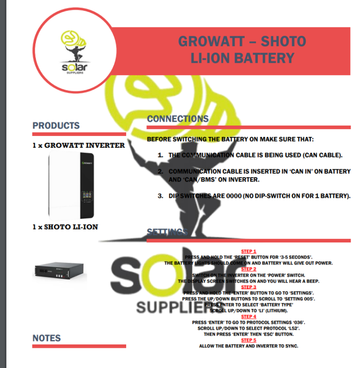

October 17, 20241 yr In addition. Solar Suppliers put out this guide, Now they talk about a "CAN" cable. So I am not sure if your battery had a number of LAN cables included for different applications? If not, make one up or have one made up. Anyhow, it states that it should work with CAN comms and protocol 52
