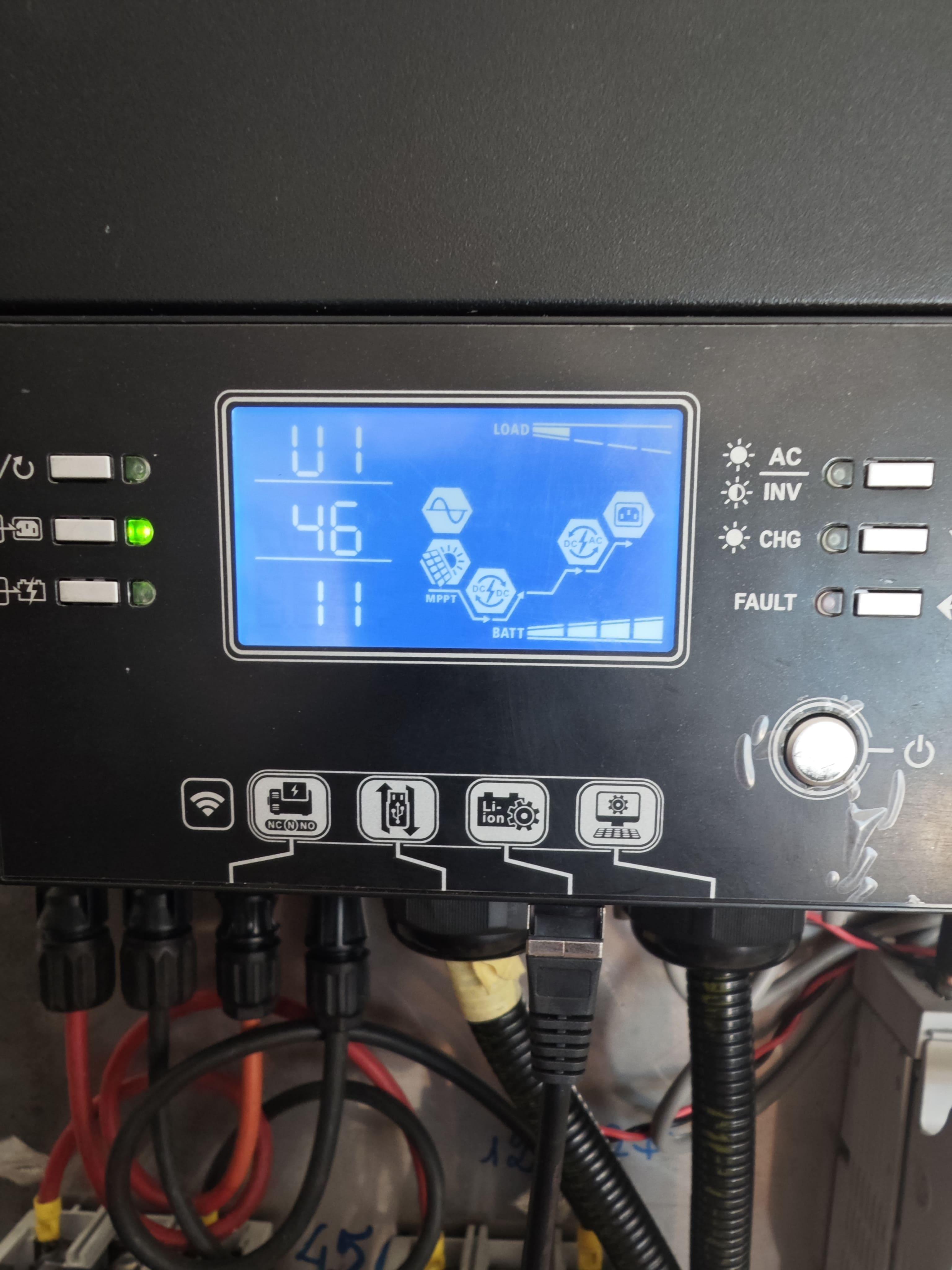

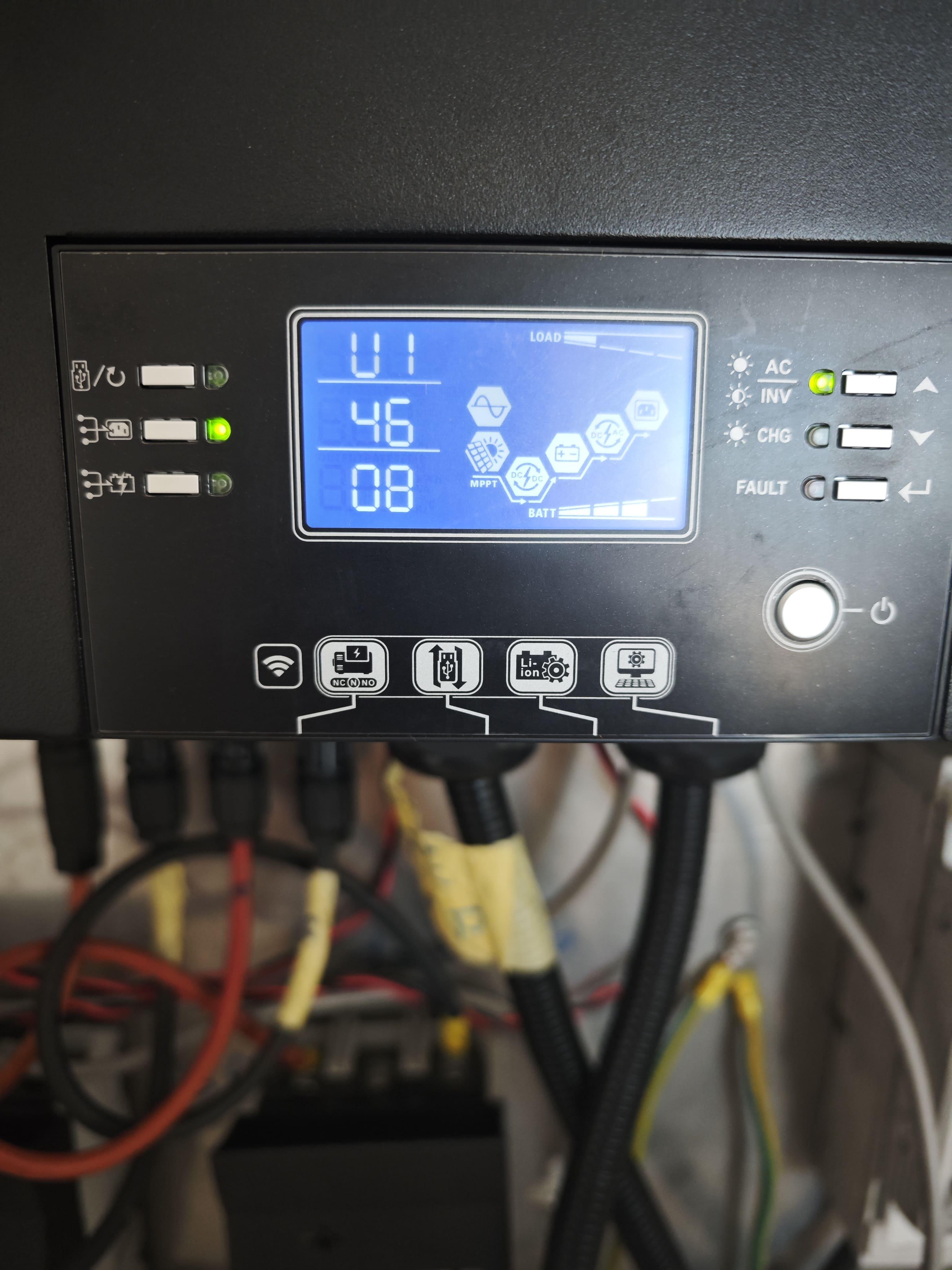

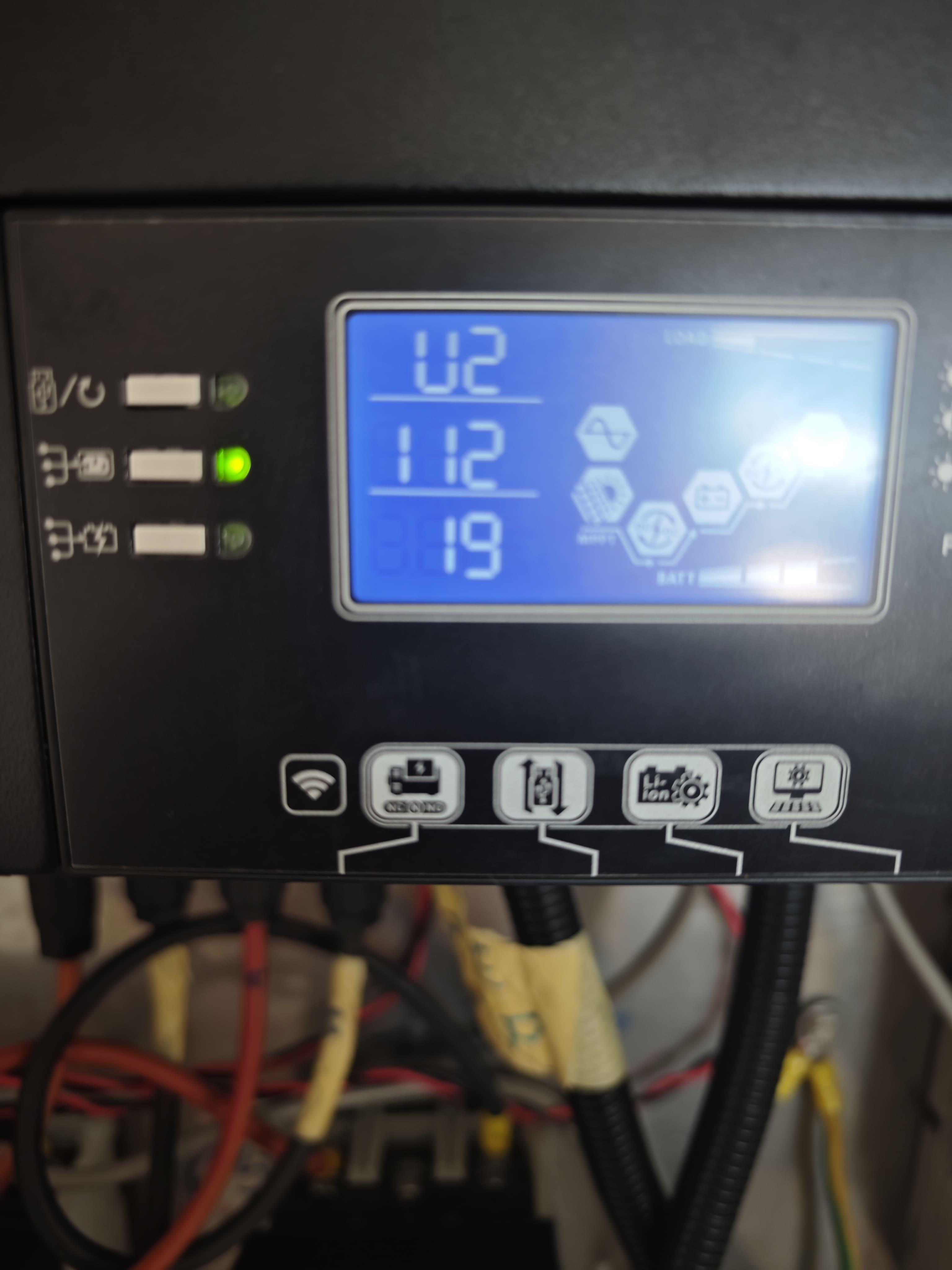

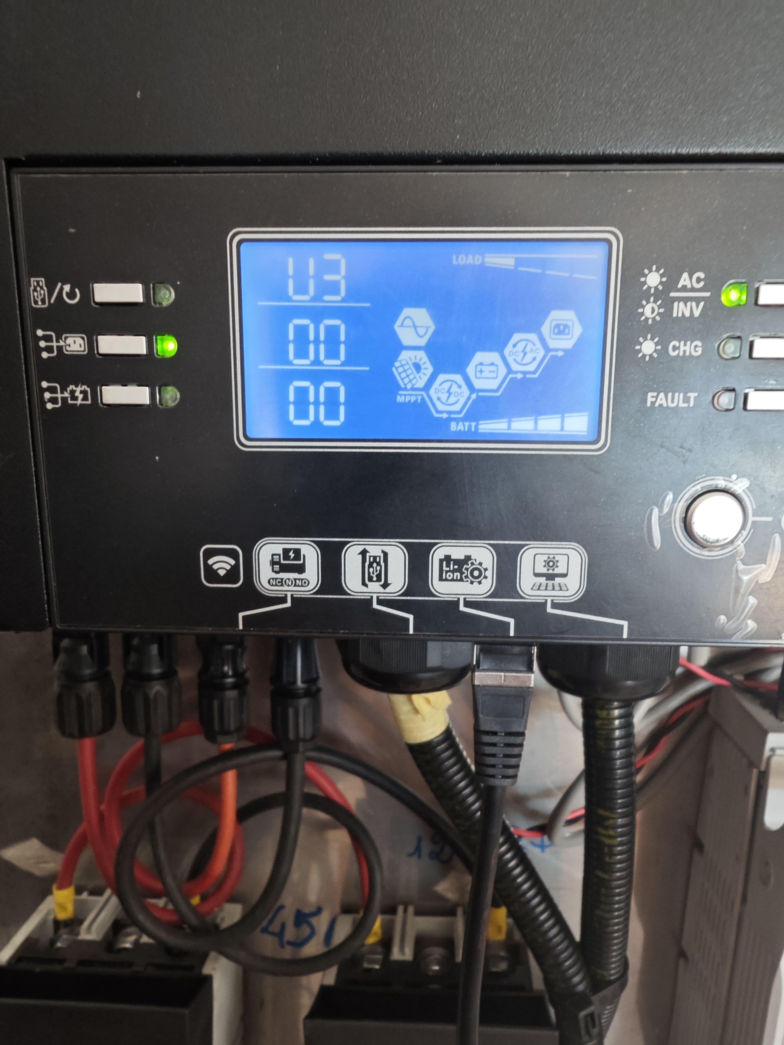

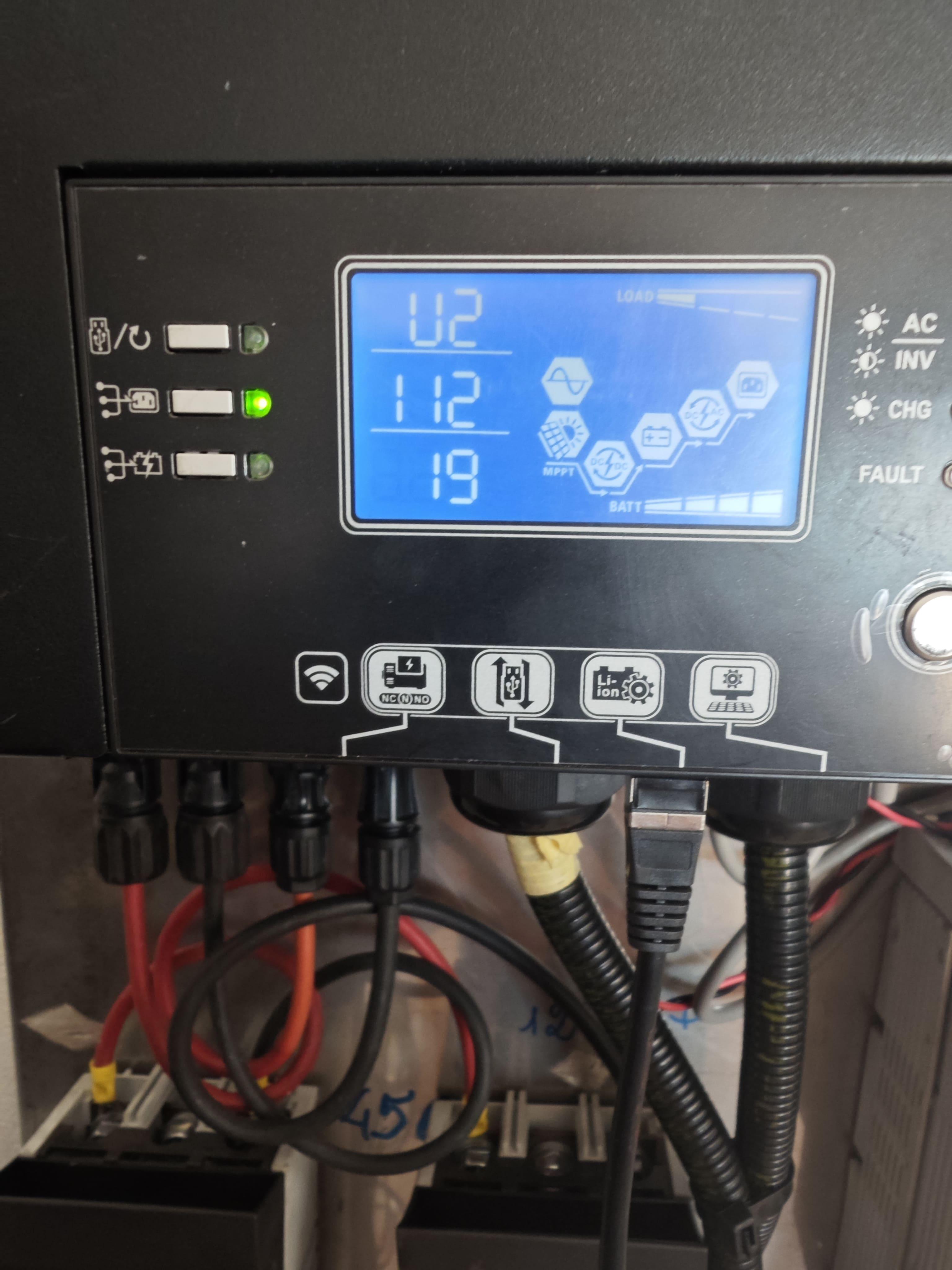

1 minute ago, Sérgio Fernandes said:
Bom dia,
são estes os valores.
Consegue arranjar os todosos frimwares (U1, U2, U3) certos para estes inversores?
Também não consigo fazer conecção via wifi aos inversores.
The latest firmware for your model is over a year old now, but it has the "presumed good" MPPT logic (so the "stuck at 90 V issue is largely solved).
It's 46.82, available here: https://forums.aeva.asn.au/viewtopic.php?p=102981#p102981
Edit: You may want to update the display firmware as well, as 112.19 is quite old. The latest in the y12.xx display firmwares is display firmware version 12.28.

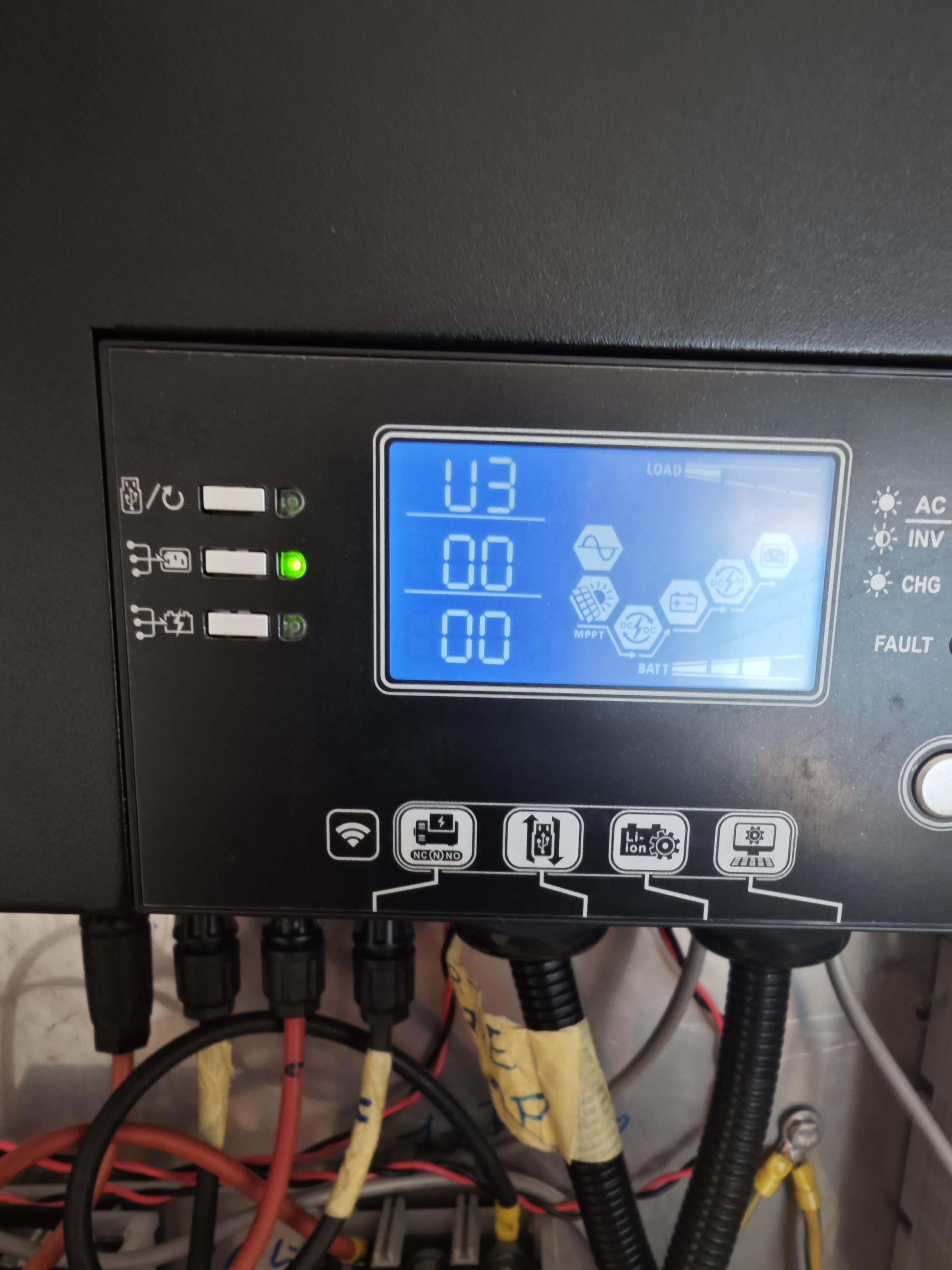

Bom dia,
Tem algum frimware para U3? A versão do meu é 00.00 e não sei se é por isso que não consigo que os inversores liguem ao router para ter a informação online.
Já tentei de tudo e também várias app e não consigo de maneira nenhuma fazer a ligação dos inversores ao router.
Pode ajudar sobre isso?
Obrigado.
I have never seen any firmware update files for the Bluetooth / WiFi processor, and I don't think that there is actually a mechanism for updating it.
Showing 00.00 as the U3 firmware version seems to be common, whether Bluetooth/WiFi is working or not, so sadly it doesn't seem to tell us anything useful.
Sorry, I don't use these, so I have no idea how to fix it.
