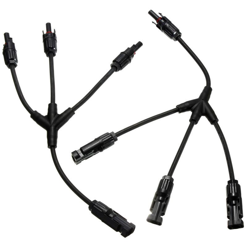

Any recommendations on making a splitter for 3 solar panels that need to connect to my trailer's single Bard Harrison plug (Solar Input).
I see you get 3-way MC4 Connectors.
I'm thinking to use this and then terminate the other end with the matching Brad Harrison for the trailer side.
Any advice will be welcome.

Could you please provide more details on wiring the
Brad Harrison connectors for 3 panels in series?
Loop pos to neg on panel connectors. Last pos and first neg to plug.
