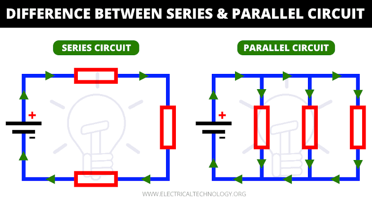

You know what, I've been using the wrong terminology.
Parallel: Live and neutral cables coming off each battery to it's own breaker then joined with a bus bar, and on to the inverter.
Series: Live and neutral from battery no 1 running to battery no 2 (live to live & neutral to neutral) then on to a breaker then on to inverter.
Totally wrong terminology, what should it be?
I've been away from solar for some time and in to other things, how easy it is to forget.
