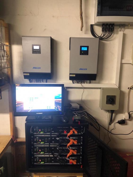

I upgraded my ICC to version 2.7.3 This morning (03-04-2019) and immediately noticed that the PVwatts does not measure correctly and possibly the battery Watts too. Has any one else experienced this or know of a fix? Attached is the screen shots.
My Setup is as follows:
1. 2 x Axpert 5kva 5kw inverters set up in parallel.
2. 4 x 2.4Kwh pylontech batteries
3. 28 x 280w panels (7840w total)
4. ICC software.

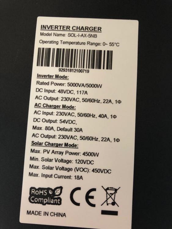

2 hours ago, jasonvanwyk said:
Hi Jaco
to be honest i don't know. I only know them as 5kva 5000w. I attach a screen shot of the inverter specs
Jason
This might be the Axpert King if it Is similar to the picture?
You have an impressive system. The Inverters are then most probably Axpert MKS II's. (Where did you buy them?)
Only question still not answered is: When your units switch to Eskom due to the fact that the solar power is insufficient, is the load shared by Solar and Eskom or is it only Eskom?
